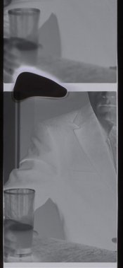

I developed a roll of Tri-X (135) yesterday, containing a few images where I try out an idea for an avatar to use here at APUG (hence the depressing man drinking milk). Anyway, the film has some strange, what I believe to be, coating imperfections that can be seen in the attached straight scan. The larger “blob” and the smaller specks have a pale yellow colour and are clearly on the emulsion side.
Does anyone know what this is? I’m interested because I have never encountered anything like this before.

Akki14
Feb 2, 2007
1,874
London, UK
Try refixing it? Just sounds like the film didn't fix (but there's no picture of the film itself so that white blob could be anything).
BobNewYork
Jan 1, 2008
1,067
Long Island,
That looks to me like the emulsion touched the next layer on the reel. Looks like no chemical activity at that point. Could the film have buckled at this point.
Only reason I say this is "been there, done that!"

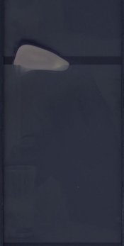

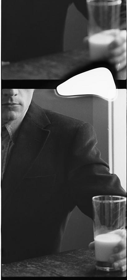

Here are two more scans of the problem:

canuhead
Mar 12, 2006
831
Southern Ont
Agree with BobNewYork, film on film contact. Refixing will simply leave clear film at that spot.
BobNewYork
Jan 1, 2008
1,067
Long Island,
Uhner:
Definitely looks like a problem loading the film on the developing reel. Do you recall if the film went on the reel easily or did you have a problem? I really think that's your answer.:sad:
Bob
Uhner
Feb 28, 2006
1,100
Oslo, Norway
Uhner:
Bob
It went on quite smooth and uneventful as usual. There are no pinch marks on the film and I did not notice anything out of the ordinary when I took the reel from the tank or opened the reel.
Anyway – I believe that you are right. Shame on me for calling this a coating imperfection.
BobNewYork
Jan 1, 2008
1,067
Long Island,
No shame! When it happened to me I saw the first blotch as the film came off the reel and cursed the manufacturer......until I saw the other blotches!!! It happens - just so long as it wasn't someone's wedding!!!:D:D
jim appleyard
Nov 21, 2004
2,421
glens falls, ny USA
This is one layer of film touching another on your reel during devving. Photo students (and those that go on to become professionals) call it leprosy. It happens to all of us at one point or another. The first two roll of film I ever did were covered with it.
