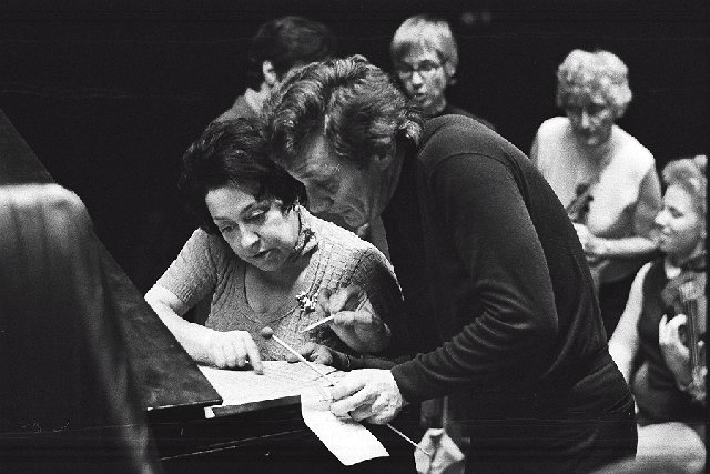

Stage photos.
Many years ago when I was first oboist of the Norfolk Symphony, I took photos of guest artists in rehearsal. The attached was of Alicia De La Rocha. My standard exposure with Tri-X was 1/60 at f/2.8. If I had use an automatic camera, my exposures would have been off because of white music in the foreground and very dark background. I was seldom able to leave my chair long enough to get on the audience side of the performer. I/60 at 2.8 will do it for most situations because the lighting person will see to it that there is that much light on the performer's face. I did not use push processing.
I tried Acufine and Diafine but wound up using my own blend of Phenidone, hydroquinone and sulfite. It was a sort of kin to D-23, but with a little Phenidone and a lot of hydroquinone. You cannot really put too much Q in because activity is limited when the ratio to Phenidone gets above a certain point. Anyway, let me see if I can show a result.

gainer
Sep 20, 2002
3,699
The developer I used was 0.6 grams Phenidone, 10 or so grams of hydroquinone and 100 grams of sodium sulfite in a liter. I treated it about like D-23. This was before I found the delights of ascorbic acid. To see the developer I would be using now, look at my article on Metol and ascorbic acid. About a gram of Phenidone, 8 grams of ascorbic acid and 24 grams of borax in a liter of water will do it.
