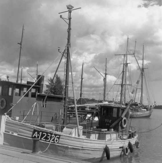

I get good results with new Tri-X in HC110 dilution H (half of dilution B). I develop for 11 minutes at 68 degrees C.

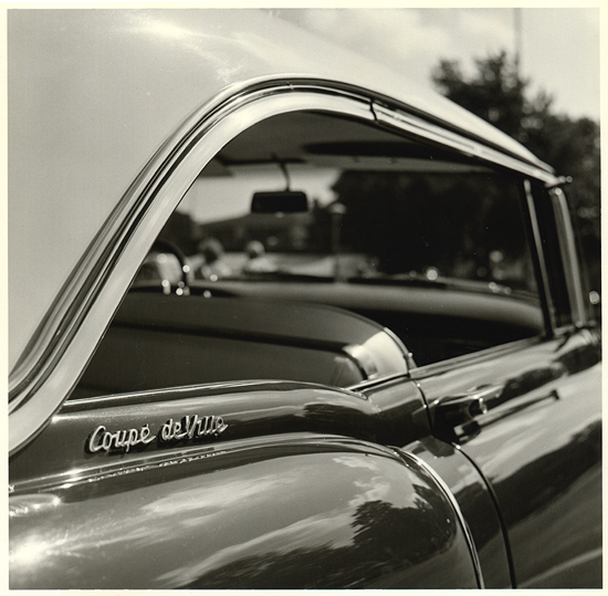

Here is an example of Tri-X in Pyrocat-MC (semistand development).
I used 1+1+100, shot at EI 200, dev at 70*F, 13 minutes (initial one minute and four inv every 3 minutes). Presoak. Water stop. TF-4 fixer.
What I like about it is how sharp it is, even for enlarging. I should probably mention that this is printed on Kentmere Kentona using Ilford Bromophen developer at 1+3 dilution.
- Thomas
