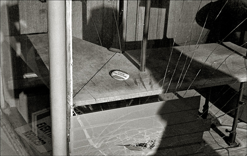

I like the Rodinal/Tri-x combo, has a kind of 1950's photo-journalism look a little more grain than say D76/ID11 but very satisfying for a certain 'look'
'Free Palestine' Tri-x in Rodinal 1:25 Leica M4-P 50mm Elmar 2,8

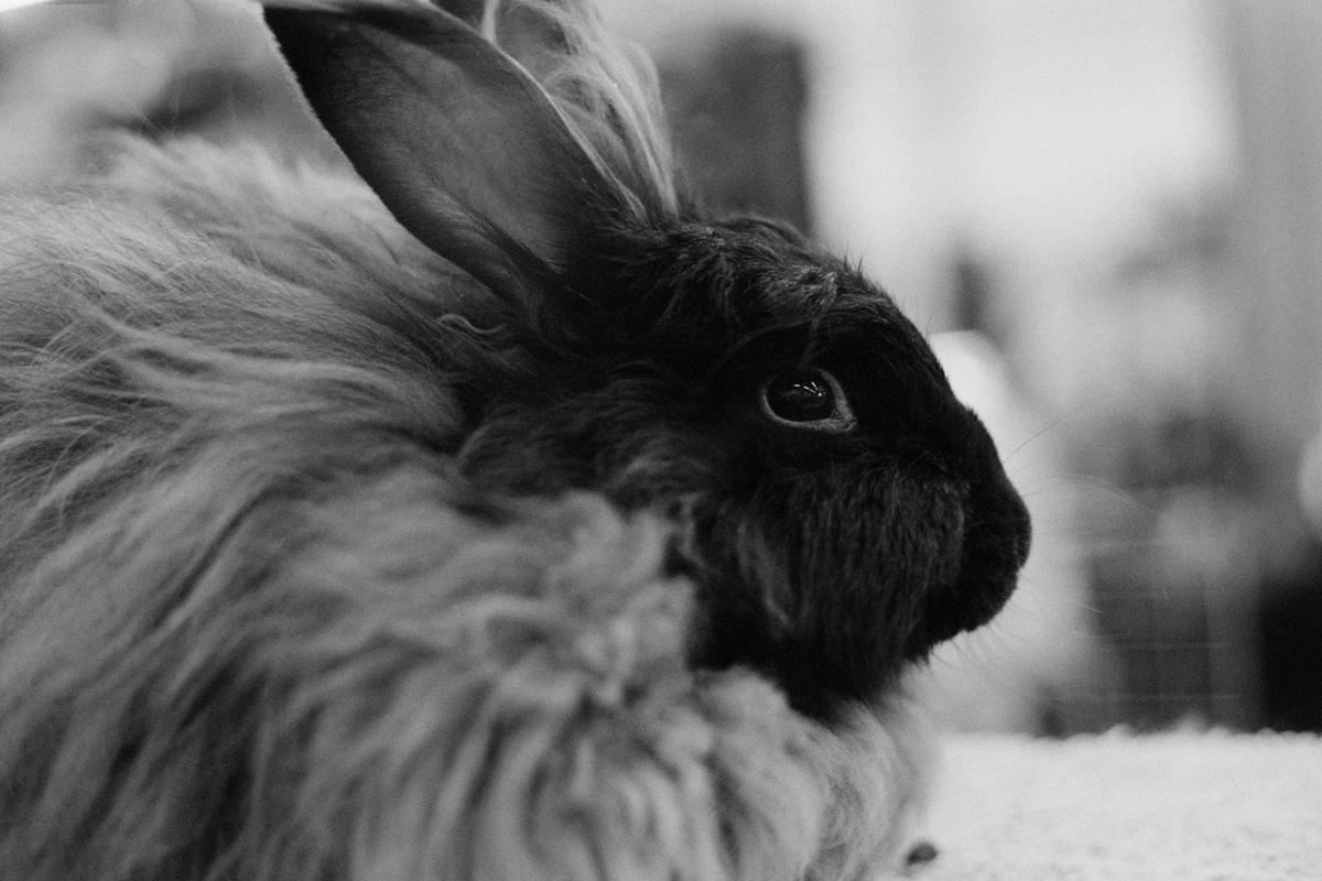

To my eye, the newer Tri-X has finer grain than APX 400, and I don't get very big grain with APX400 and Rodinal 1+25, agitating every 30s like Agfa suggests.
Attached picture is just a negative scan; the print wouldn't show the effects of grain aliasing, which increases the apparent grain.
It's also fun to shoot Tri-X at 200 and over-develop it. Get a 250W bulb for your condenser enlarger and print patiently. Makes wonderful prints with a very interesting and beautiful tone reproduction.
To me, Rodinal is all about texture, no matter what film you develop in it.
