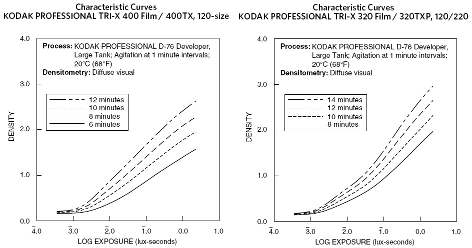

OK. For 4X5 Tri-X, my only choice is ISO 320. For 35mm Tri-X, my only choice is ISO 400, whether from Kodak or Arista Premium. Then, for Tri-X 120 I have a choice of 320 or 400. What would lead me to choose one over the other. I use 120 in a roll film back on my field camera and in an elderly twin lens reflex.

It contains the characteristic curves for both films in 120 that I've attached here. From this you can deduce that the 400 version has a straighter response across the grayscale than the 320. The 320 has more of a curve with less separation in both shadow and highlight detail.
If you shoot the 320 slightly overexposed, and use a compensating developer, like Rodinal or Pyrocat, you can get similar results to the 400.
