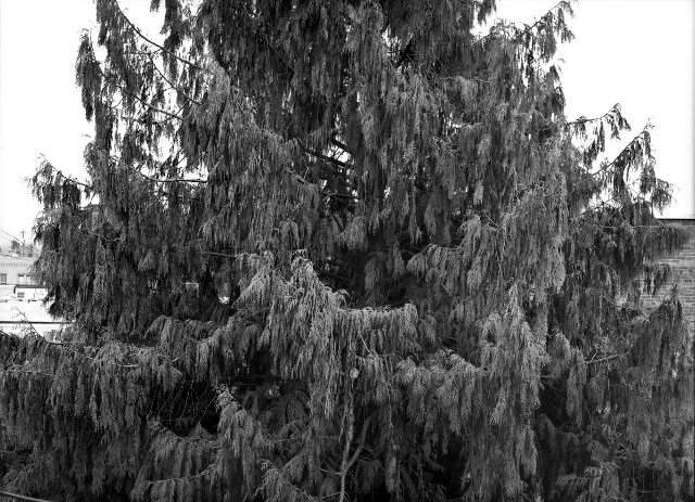

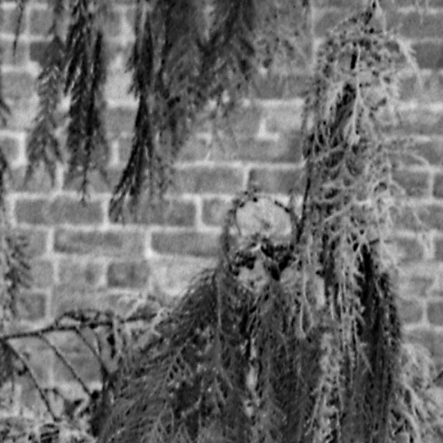

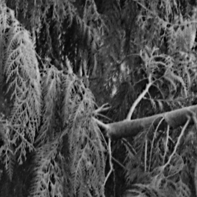

Uneven development? Take a look at the attached files. This was done with refrigerator development, ala William Mortensen. I used Fuji Acros 120, in Ilford Ilfosol 3, for five days. Now, do you see uneven development?
Do you have any negatives with a smooth tonality surface instead of strong texture, like a blue sky that has some tone in it? That's usually where you can see uneven development.
Some people do standing development all the time, and never face any issues, and others have never ending issues. I was one of the latter ones, with lots of problems with bromide drag. Rodinal and Pyrocat, with different films.
There are many accounts of this occurring, so please don't dismiss it just because you're successful, lucky, or know some trick the rest of us don't have.
Brian C. Miller
Dec 13, 2010
486
Everett, WA
Right off hand, no, I don't have any with large sky areas or similar.
Here's my technique: Dilute Ilfosol 3 normally with cold water. Pour into SS container, give it a martini shake for a little bit, and put it in the fridge. Give it a martini shake in the morning, and a martini shake in the evening.
Mortensen developed the technique for use with nudes. If there was a consistent development failure, I'm sure that he would have abandoned it.
Of course UNEVEN development. The whole POINT behind shaking a developing tank is to get the MOST EVEN development as possible. It's Scientific.
Now, I can see how a 5 days development might get even development: It's such a long time that each day's Bromide Drag is getting more Drag from the next day's shake that eventually it's so dragged that it becomes unnoticeable, just like splotching black paint on a wall, day after day, makes for a perfectly even Black wall. Eh?
Besides, how exactly do you know when the developer gets exhausted? Maybe it's exhausted after12 hours. Why keep it for 5 days, then? That's so unscientific. Fun but unscientific.
Brian C. Miller
Dec 13, 2010
486
Everett, WA
YEEEHAAW! It's the old Adams-vs-Mortensen "war!" :tongue:
Well, NB23, I can only show you what I have that works for me. You want to experiment with it for yourself? Go for it! Or not. I can only post the results. If you can find a flaw in the image that I've posted, please point it out. The refrigerator development isn't something I normally do, as I like to get back my film a lot faster. But I have proven it for myself that it works, and really, that's what counts.
The film was scanned at 3200spi, and the two crops are at 100%. Mind you, the film has more detail than my scanner will resolve. (which is why I prefer my Omega!) I've shown my negatives to a very experienced printer, and he was quite impressed.
