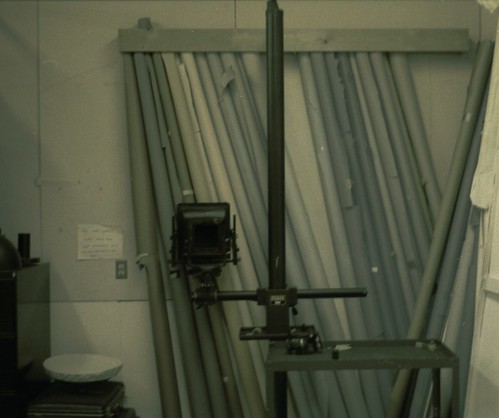

Here are the results from some rough scans:
Velvia 50 exposed at ISO 50
Developed in Rodinal 1:25 for 9 minutes with constant agitation
cleared with a mixture of:
.5 oz Flexicolor Tank Bleach
9.5oz Flexicolor Fixer + Replenisher solution
developed in HC110 dilution B for 8 minutes with constant agitation
I am very excited with the results so far even though they are just simple test shots.

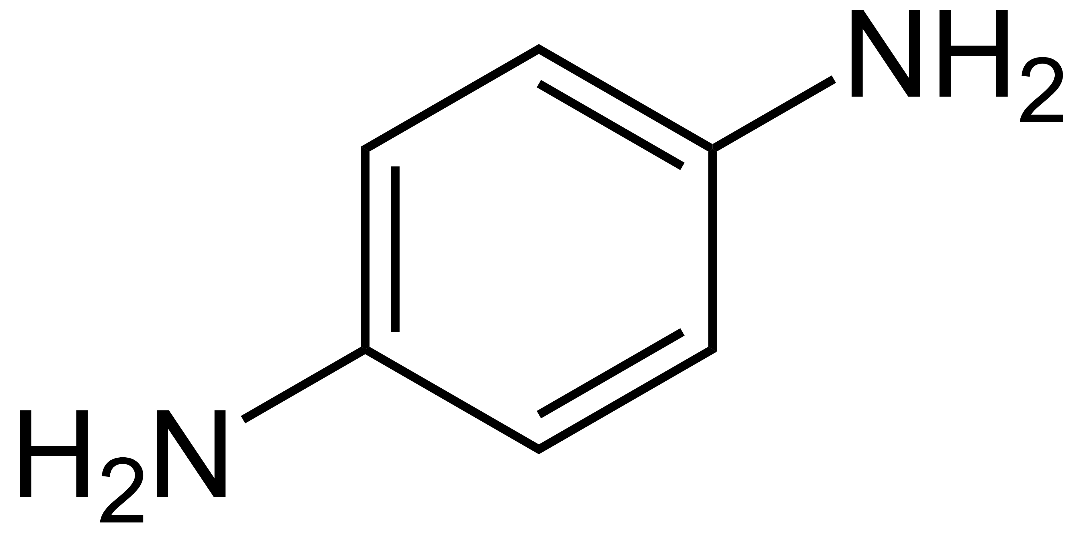

p-phenylene diamine (it and its derivatives as the secret sauce in CD's)
4-aminophenol (Rodinal, hydrolysis of paracetamol)

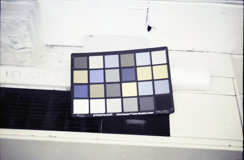

Okay update, did a roll of Reala 100, shot a colour chart @ ISO 100, and -1, -2, -3, -4, -5, etc stops.
The negatives look pretty damn great to me, -1 and -2 seem the best, plus a few back yard scenes.
I think there is colour there, but its hard to tell with C41 with its orange mask on top of everything.
Development was 1+20 Rodinal, 24c for 31 minutes, plenty of agitation.
Just waiting for them to dry.
little bit of pushed saturation from one of the best exposures (4 stops underexposed from ISO100 - ie: ISO1600) -
OKay now.... levelled the colour channels individually using levels in Photoshop... then used channel mixer to swap the green and blue channels... then I did a Hue and Saturation, -36 on Hue and +66 on Saturation (also previously did heavy noise reduction on the colour targets as they could be seen without random colour noise affecting them so much from the scanner from such heavy processing).
Result: Red, Green, Blue on the left strip, Cyan, Magenta (kind of), Yellow on the right strip, while everything else is fracked up :D
But hey, the colour definately has been developed and discerned, they also all seem a bit dense with a small range (to the scanner, but look great to me), as I did a small bleach mix with plenty of fixer like the OP, am going to fully bleach and fix them now to see how much of the image is contributed from the silver, and how much from the dye.
edit: I'd say 90%+ of the image is from the silver layers, I bleached and fixed one of the really dense shots of the colour card and almost no image remains (but denser then the first tests on S800).

Guys, I just had a thought that might help.
Rodinal has a VERY high level of Sulfite compared to color developers and the Sulfite is a powerful competing agent for oxidized developer and thus prevents dye formation. A special mix one-shot of pAP with low Sulfite might give you much more intense dyes. IDK, just a thought. I am not sure of the final level in the working solution but I would try to reduce it by 50% - 80% just as a test, if possible.

This is 4x500mg tablets of paracetamol with sodium hydroxide... for 1 hour and 15min, 20c as I calculated 3.6 tablets for 1+10 parodinal/rodinal based off given 'net data.
I didnt want to lose any, so I didnt filter it... and its interesting you mentioned sulphite in that way, as I read a common filler for paracetamol tablets is sodium metabisulphite and I read on APUG somewhere sodium hydroxide converts it to sodium sulphite.
So that gives me a good mind to go back and do my methylated spirits + coffee filter to take it out
I didnt have to do any channel swapping on this one, still very thin.
