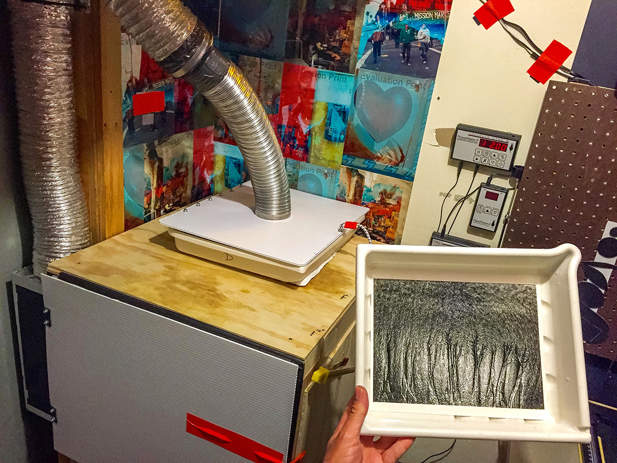

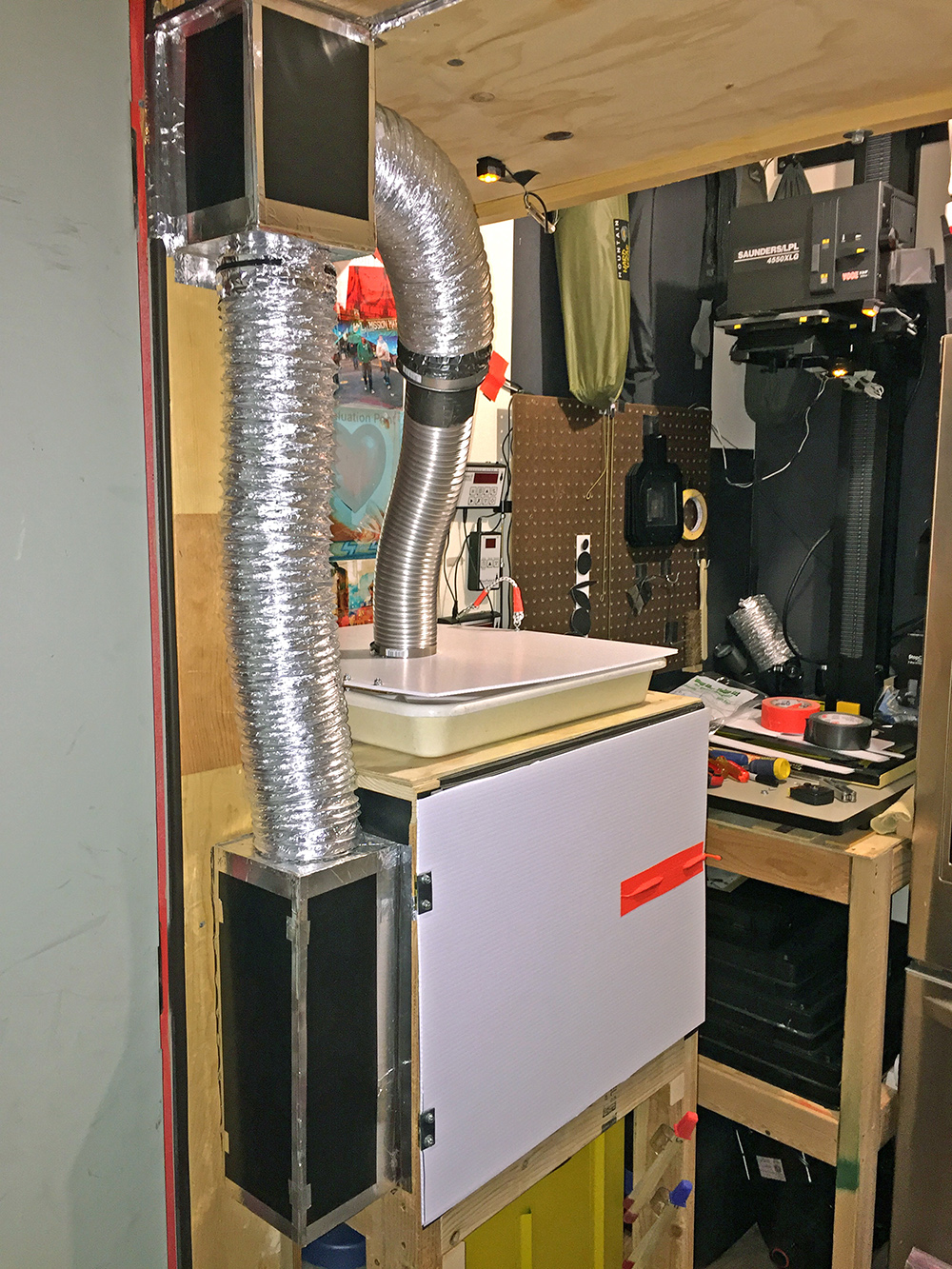

In my old closet darkroom, I built a tray stacker that handles up to 16x20 trays. It's final iteration had an improved ventilation system that made it bearable enough to make exhibition quality prints. I have since bought a house specifically for the 500 square feet of dedicated darkroom space it has with a total of 1,000 square feet for my photography business overall.
The stacker worked well for quite awhile:
