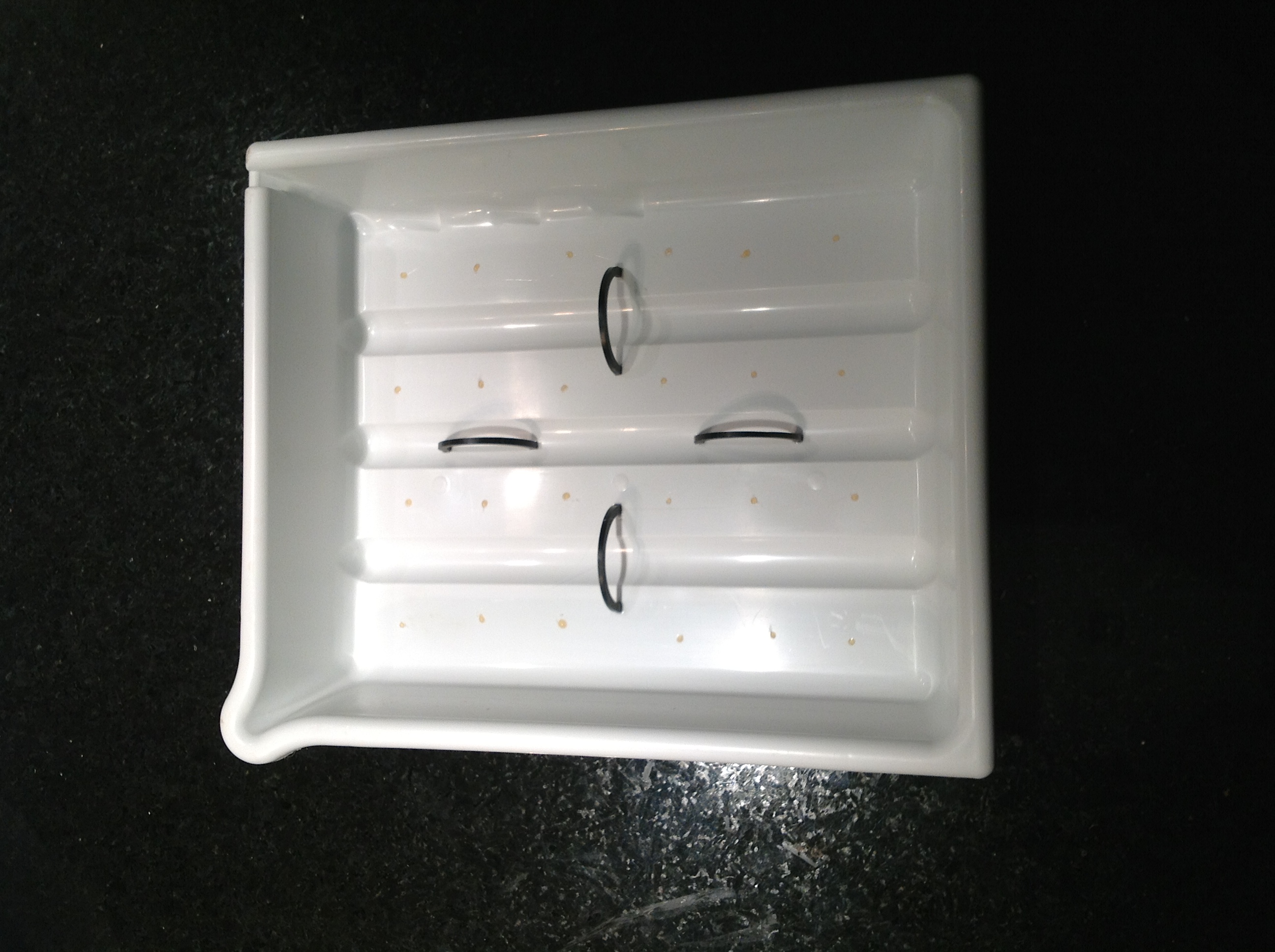

After unsuccessfully trying shuffling negatives in a tray, I modified an 8x10 tray by cutting 2x2"x1/8" ABS pipe cut in half (I'm sure 1 1/2" pipe would work just as well) using a miter saw to produce 4x1/8" half rings and gluing them to the bottom of the tray using Superglue to create 4 "chambers."
Cost me nothing but my time and works like a charm. The same tray can be used for each step, and I never handle the negatives. I set out all my chemicals in order on my right including water for a water bath; tray sits in a water jacket (room temperature is too high) in front of me pouring spout at top left; I empty the chemicals to my left: water bath & developer down the drain and the others into the containers I poured them from. 450-500ml of developer ensures that the sheets are covered. I use intermittent agitation: 60 seconds agitation and 10 out of every 60 seconds until the time is up.
Pictures, for us that dont use arms and legs to measure. Pretty please with sugar ontop.
As you wish. The little "dots" are from a glue gun. Keeps the film barely off the bottom. How you get there (i.e., no arms, no legs) doesn't matter as much if the final product works:wink:
I failed to mention in the original post that the emulsion side goes UP.
