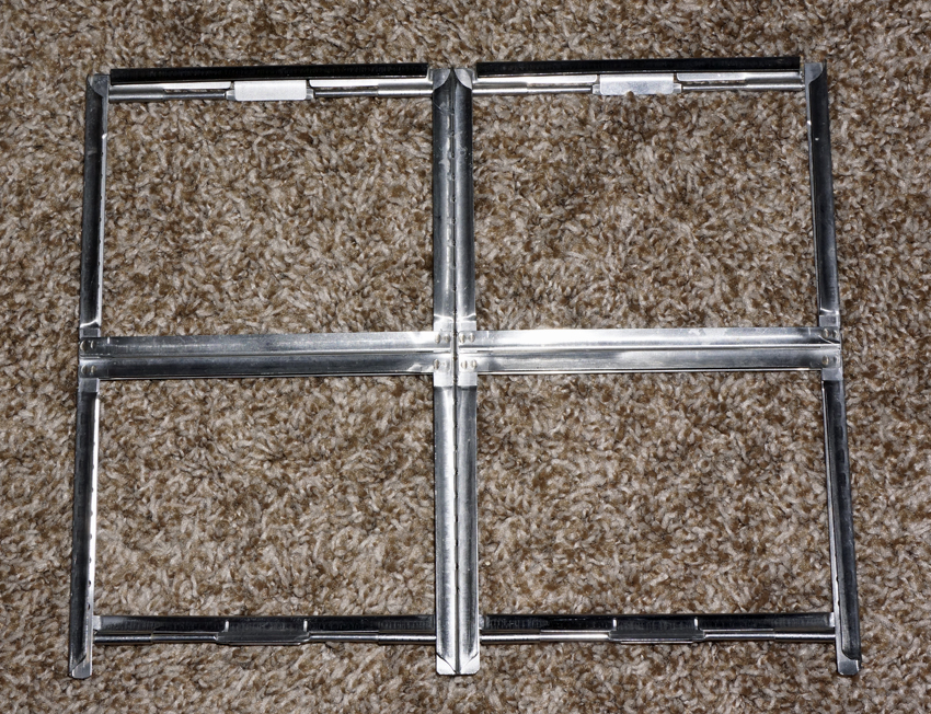

When tray developing 4X5, is it necessary to rock/slosh the tray? If I am using the Kodak negative holder that takes four 4X5's, can the negatives be left in it for drying? If so, is it best to stand it vertical, or lay it flat? I am using 8X10 trays.
Thanks,
Gerry

Remove the negatives after processing and wash and hang them in a dust free environment.

When developing any film in any format, the primary principle behind agitation is so that fresh solution is brought to the emulsion, moving away the depleting solution that was in contact with the film. So, yes, you need some form of agitation...whether lifting film holder out of solution and then placing it back (in the case of vertical hangers) or in tray processing. Rocking/sloshing the tray should be sufficient.
A very long time ago I used to process a stack of sheetfilm, pulling the bottom sheet out and placing it on top of the stack, a continuous leafing action thru the entire stack, for the entire processing time. Kodak agitation assumed sheet films agitated 1x/min., and you could do continuous agitation by adjusting the developing number by 3 (similar to assuming 74 degree processing rather than 68 degree processing)

and yes, you can leave the negs in the film holders to dry. I just hang them from a clothes line.

I would remove from the film holders and hang from a corner. The holders are U shaped & may not drain every drop out quickly for drying.

when i used hangers to process film
i was warned by an expert to remove them from the hangers
because the emulsion could stick to them, not sure if this is true or not
but i followed the advice.
is there worry of streaking with a 4-up film holder?
i know when using them in deep tanks there is risk of streaking
if it isn't put in gently ...
