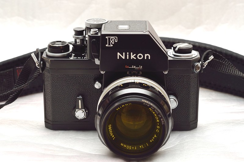

I have a great looking black FTN Photomic that shutter speeds are accurate and meter functions. The only problem is a tiny piece of trash of some sort at the very middle of the meter at the top where it looks like an inverted "V" where the needle moved to indicate proper exposure. That piece of trash, insect or whatever it is is right in the middle of that "V". It doesn't seem to impede the movement of the needle, just distracting.
I've tried blowing every nook and cranny I could find to dislodge it to no avail. Any ideas what to do or who could fix this? I tried taking a picture of it and couldn't get the right angle as it's way up at the top.

If one of the chrome ones is nice, grab a Wiha 1.5mmx40mm slotted screwdriver. Swap nameplates. Done.
-J

Try calling Doug at Camera Clinic up near Seattle, 306-367-2440. He specializes in repairing these and has a lot of old Nikon spare parts. Communication was great and the price was reasonable.
If that debris can be cleaned from the finder, he should be able to do it.
He restored my FTN head which was near-mint, but due to age the meter was non-responsive. He overhauled it and converted it to accept modern 1.5v batteries. The camera now looks and functions like new, probably never having more than a few rolls run through it since the 70's.

That's why you replace the nameplate. Put your nice black plate on an ugly but working chrome one.

So? Swap the nameplate, then find a nice FTn finder that doesn't have desilvering in the prism and put your nameplate on that one. The chrome FTn finder on my current F was originally black, but I changed it over when I had the finder on a chrome body. Alas, the originally chrome finder, which was mated to my previous black F, wound up being sold to someone here. Otherwise, I would've switched it back. Since I plan to get another eyelevel finder later this year, I won't bother with switching the nameplates.

That nameplate swap worked nicely, didn't even think of that.

Panda cameras? I have one black and two chrome FTN's. The meters work in them all. The black one is spot on with my Luna Pro SBC meter with the MR9 adapter. Taking one of the chrome meters that works well and replacing the face plate with the black one from the "Apollo" FTN and putting it on that one will give me a good meter without the "trash" in the viewfinder.

"nameplate swap" confused me - you're swapping the "buggy" internals from your black FTN head for the clear internals of a chrome FTN head.
By "nameplate swap", I thought you swapped just the front "Nikon" plate and internals stayed the same, thereby creating one of those Panda things.

You take the "nameplate" off the black FTN and swap it for another good chrome FTN meter. They both have a black meter but not the nameplate.
This shows the black one. There are several screws at the top and sides of the front that say "F-Nikon". Remove those and place it on a good one that came from one of the chrome versions.
