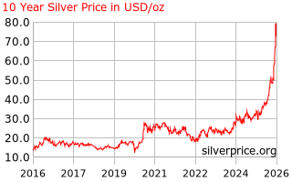

Hopefully I can link to that image without too much trouble. That should explain a lot about what's going on with B&W film prices now. Those who haven't jacked it up yet will be once they have to buy more silver.
2F/2F
Apr 29, 2008
8,031
Los Angeles,
If that was the only reason for Ilford's price increases, then the percentages of price rises should be similar to other manufacturers. But see my comment above. Their price rises in the past five years on paper are at least 4x the rises of my favorite competitor, Oriental. And it is NOT just products containing silver. Chemicals have gone up significantly, and the price of silver should have no effect on that. Some possible explanations floating around in my mind are as stated above: the business is suffering badly and they have figured that these are the prices they need to charge to stay afloat, or it is a premature attempt at positioning themselves for an "elite" group of film users.
