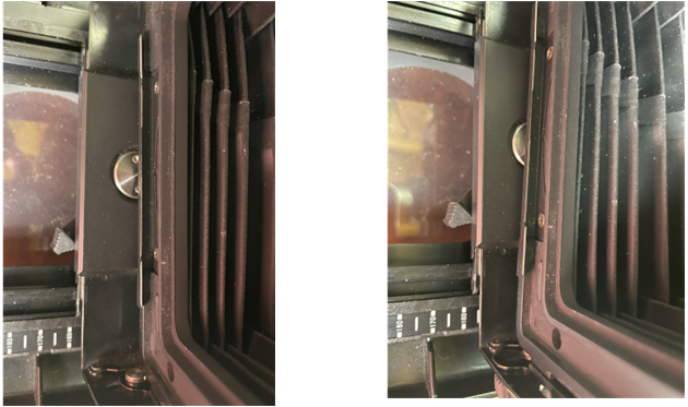

Well, I have discovered the front neutral position is sloppy from wear so I just need to be careful. Adjustment of tilt if done unevenly on the left and right can add a small amount of twist on the front.
the picture shows how this can happen. I did this to extreme just to illustrate.
