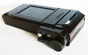

Hi! This is my first post.
I just got my Toyo 69 roll film holder.
one like this in the picture bellow.
Isn't there a part missing to slide it under the GG of my Toyo 45a ? It seems that the holder is not wide enough

Welcome to APUG. I am not familiar with the Toyo holders, but going from the dimensions the part shown looks as if it is either intended for a medium format camera rear/back or it is simply missing a part like a mounting plate to attach it to a 4x5 camera (me thinks the correct part for your application would look like the one here). Return it to the seller and get a refund.

Toyo makes (made?) roll holders with two shell sizes to fit, respectively, 2x3 (6x9 in metric) and 4x5 cameras. It appears that you have a 4x5 camera and a roll holder to fit a 2x3 camera. Sorry.
