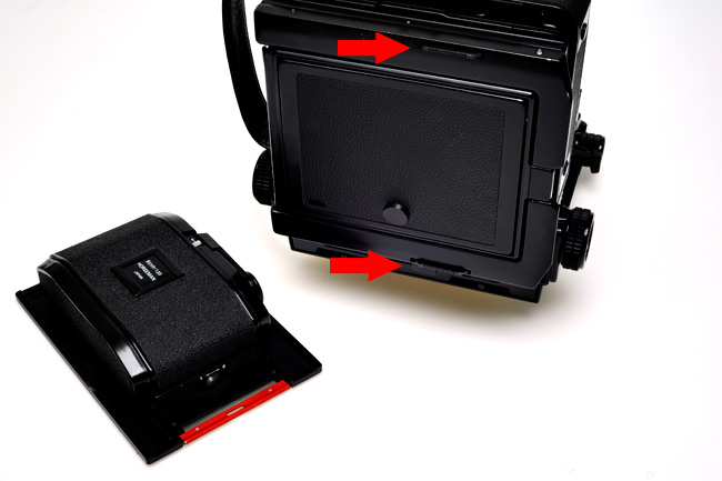

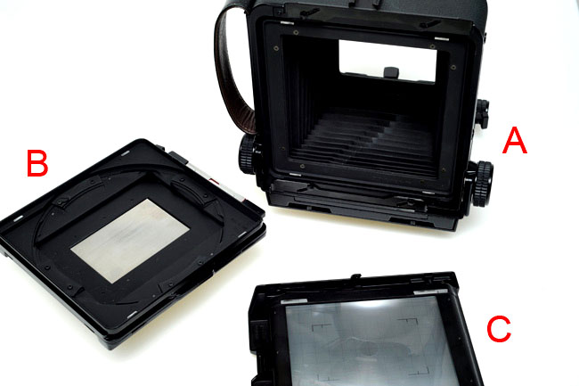

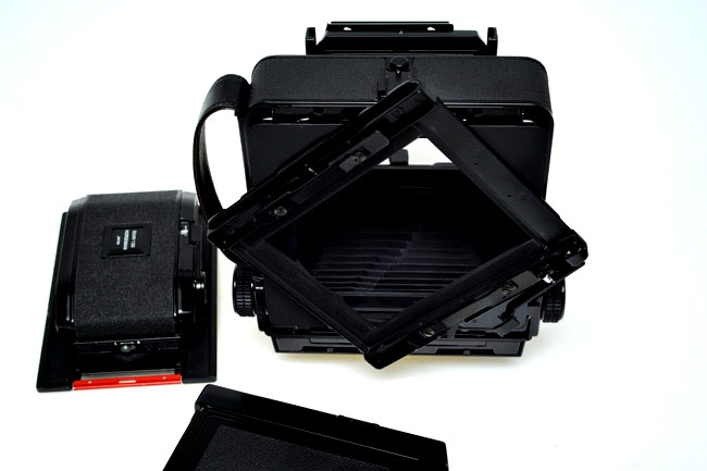

Rollei fan, you can take off the ground glass in any position. See pics...
Pic 3 shows the back with the folding viewer. The red arrows point to the buttons for removing the groundglass/springback.
Pic 2 shows the camera back with the ground/glass spring back removed. The graflok back can be revolved and used in any position on a 360 degree scale without vignetting.
Pic 1 shows the same, but with a Graflok type film holder attached.
Pic 4 shows the camera (A) with the revolving back removed, the revolving back (B) with the film holder still attached to it (you can see the darkslide from the side that normally faces the lens) and the ground glass/spring back (C) also shown from the side facing the lens.
