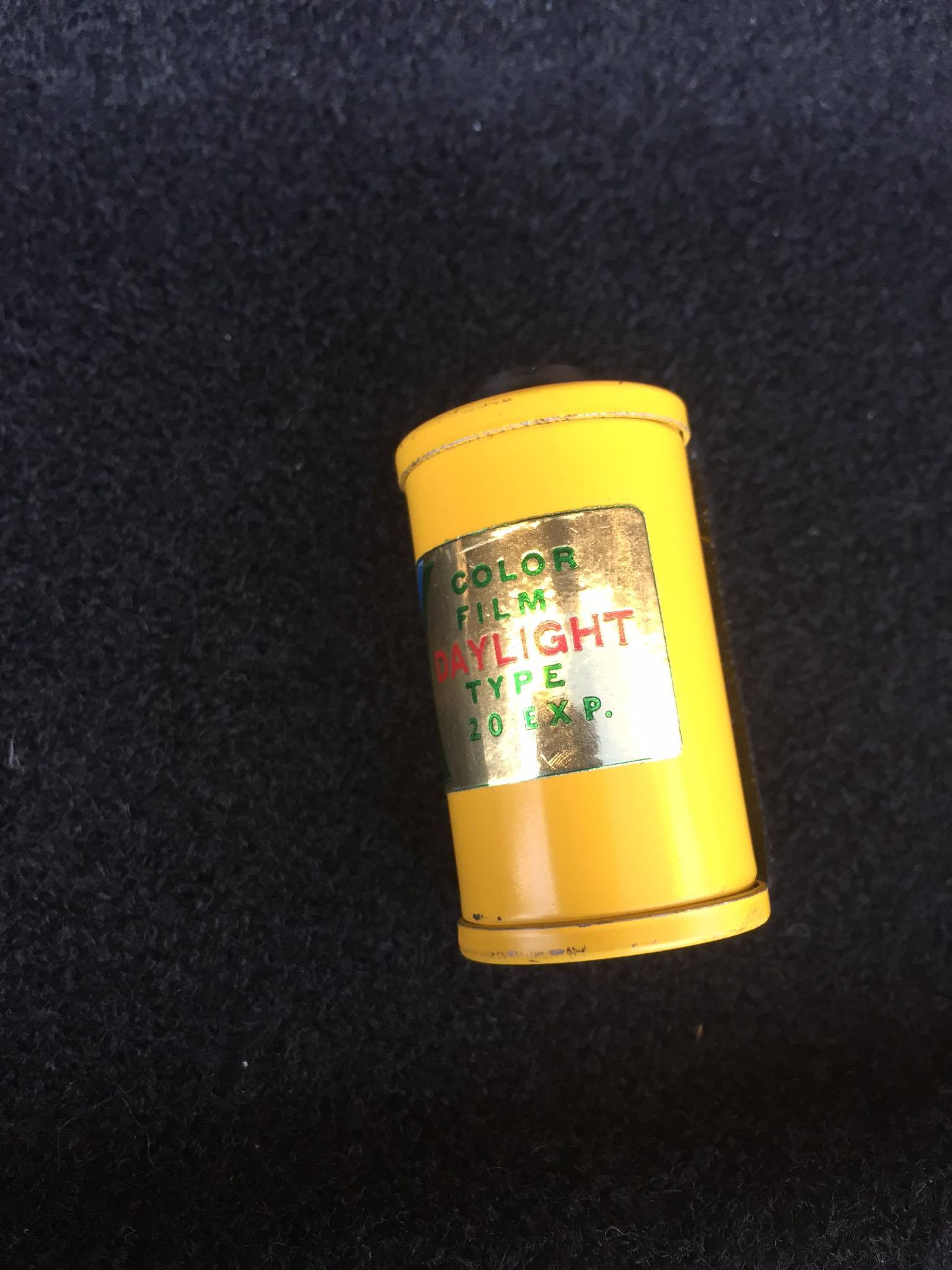

I bought a Tower 57-A with three lens filters and a wide angle lens on Saturday, it even had the owners manual, lol, (score!). The camera had an exposed roll of Tower Reversal type Color DAYLIGHT type film inside (125 speed maybe?). The canister does not give me any clue to how it might be processed, i.e. what chemistry is required. The camera was made in Japan, presumably in the 60's and I can assume that the film came with the camera from the manufacturer. my first reaction is to take the film into my Pro Lab to see if they can send it out for processing. I would love to be able to tell them what I need in case they haven't seen anything like it either.

I'd be curious to see a picture of the film cassette.
I know that one incarnation of Tower Reversal Color was rebadged Dynachrome with a film speed of ASA 10 and K-11 process (i.e., a copy of original Kodachrome)
It went to 25 in the mid-sixties (well after EK had introduced Kodachrome II), and may (later) even have been Ferraniachrome.
Is the backside of the film a deep black?

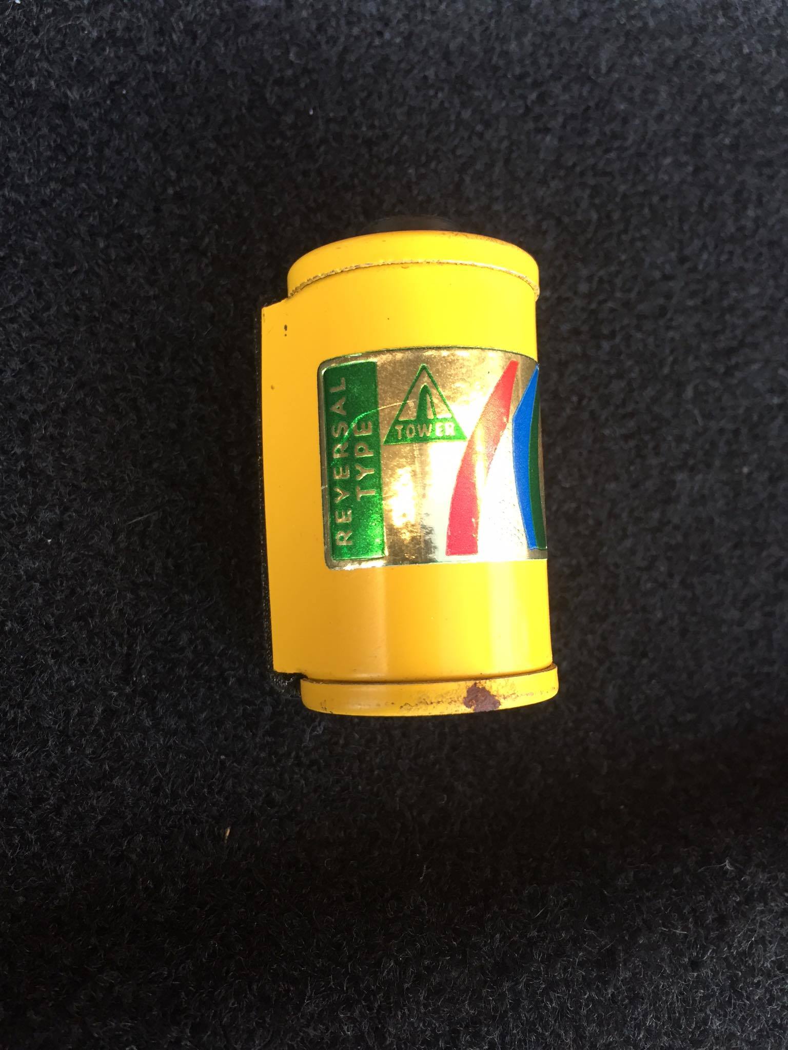

I don't have a leader puller and the camera shop in town, San Antonio, Tx. doesn't carry them so I cannot check for the rem-jet carbon backing signifying Kodachrome/Film Stock.
I found a shop in Austin, Holland Photo Imaging, that does two hour dunk developing for 7dollars a roll and that's a good enough reason for me to drive to Austin, lol.
The tech I spoke to at Rocky Mountain Film figures the film is either E-4 or K-2.
The can is flat yellow metal with no indications on the label. 12675123_992343520834791_1201797996_o.jpg12722195_992343507501459_326332788_o.jpg
