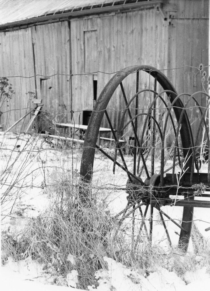

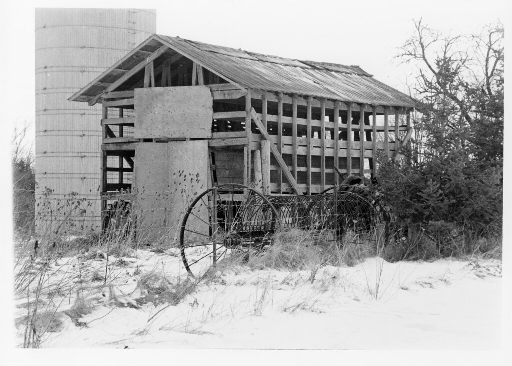

sun of sand, I have tried using the paper without a filter and it overexposes in about 3 seconds at f8 and at f16. I am thinking that I need to have the contrast filters in there to get enough time to print the neg. As I have managed to get some decent prints I think I am on the right path here now.
Here is a couple of the prints that I did today.
