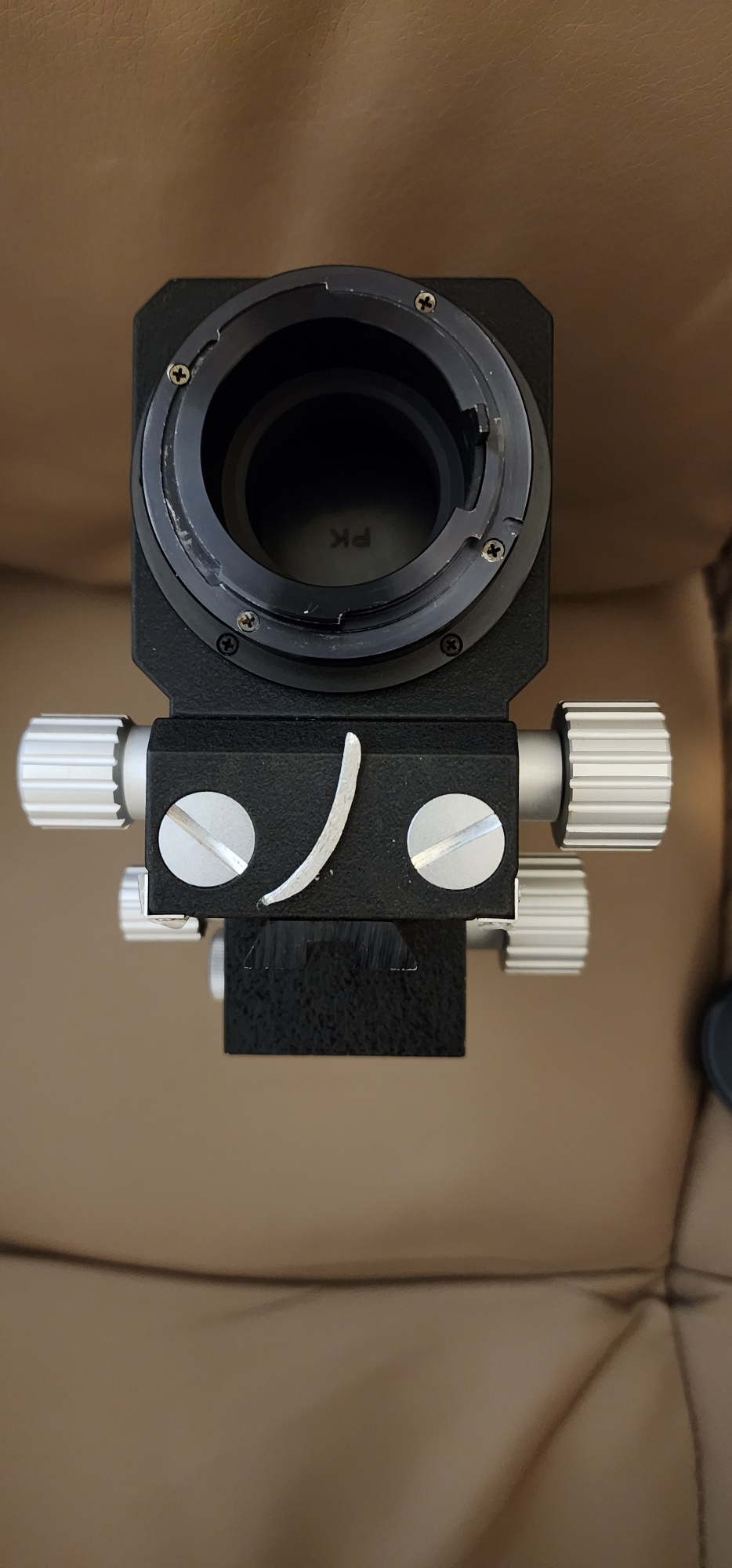

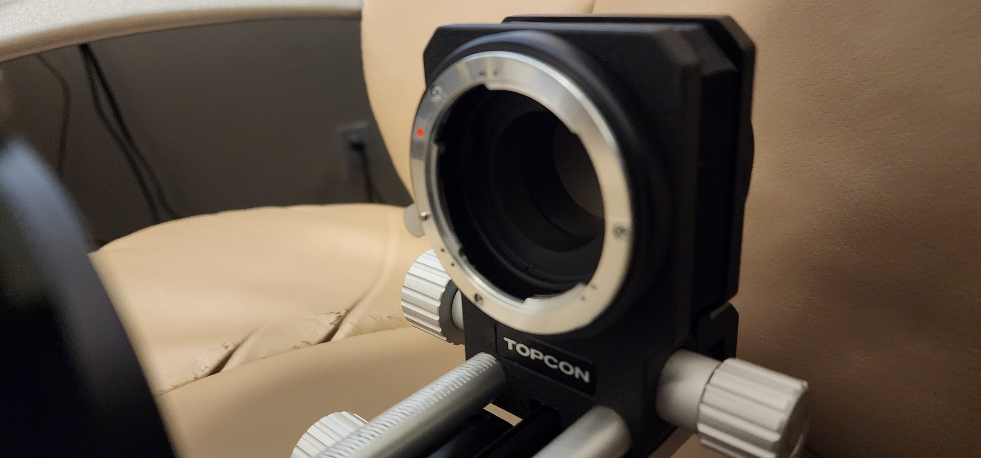

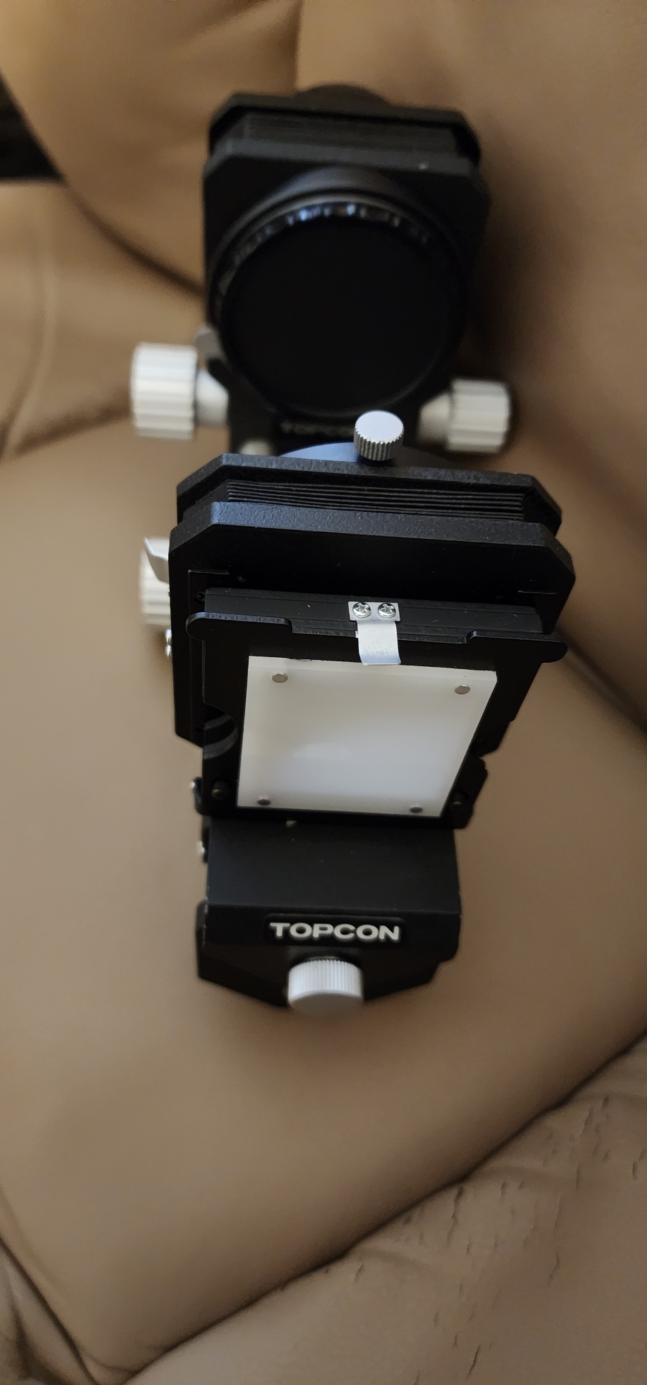

I took delivery today of an item purchased on the auction site. It's a bellows unit with the slide copier attachment and an integrated focusing rail. It is marked TOPCON but does not look like any of my other Topcon bellows units. Also, it's in Pentax K mount. The Pentax K mount has two pins. One protrudes and one is recessed. The bellows unit only contains the pin which protrudes. The unit seems to be very well made. I will attempt to attach some cell phone photos if I can reduce the file sizes. I think that when Topcon stopped making cameras, the Topcon name was used for things they didn't make. It's like the Kodak name on some AA batteries I recently bought at a local supermarket. I prefer Energizer Industrial AAs for anything important but the Kodak ones will do for flashlights and TV remotes. Has anyone seen bellows units like this one with the Topcon name but with other non-Topcon mounts?

Has the Topcon label in substituted for Pentax on the equipment? If so think about returning it.

I have not, but the last Topcon made was an RE in K mount, as I recall they also made a few K mount lens as well. this might have been made for change over. I read an article on a long dead web site devoted to Topcon and Swiss Alpa cameras that Topcon was going to come out with a complete line of K mount cameras including a K mount version of the Super DM. The author was unsure why Topcon killed the project.

The only Topcon I know of with a K-mount was the RM 300 (also sold under several other labels). It was not made by Topcon, but it makes sense to think that they simply took the most recent "Topcon" bellows and stuck a K-mount on it -- and Topcon label.
https://camera-wiki.org/wiki/Topcon_RM_300
