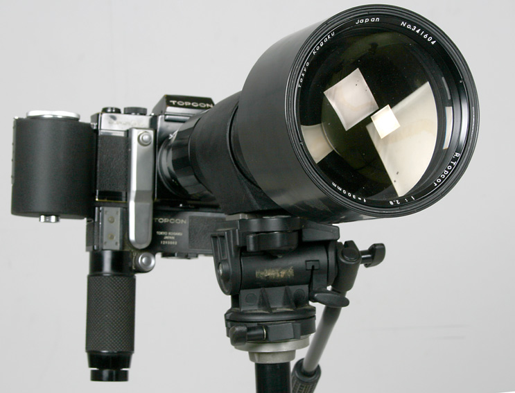

right - but if you can get the original lenses as seen in the attachments, who want to search for others.. :wink:

Forget the lens---what is that giant thing glommed to the back of the camera? Some kind of rollfilm adapter? (But the image gate is still only 24x36, so what would be the point?)
If I had a lens like that 300mm lurking in my house, I'd want a team of friendly little Exakta lenses to defend me from it in case it went rogue some night and came after me! :smile:
-NT
250 exposure back. They've been made for many cameras including, in alphabetical order, Canons, Leicas and Nikons. The back holds a lot of perfectly normal 35 mm film.
And Pentax MX and LX. And Minolta XK. And Olympus OM. I suppose Contax RTS, also. I think that's all.
Nikon made a 750 exposure back, too. It takes a full 100 foot roll.
indeed - about 8 meters of film - and also a big unhandy electric motor attached.
