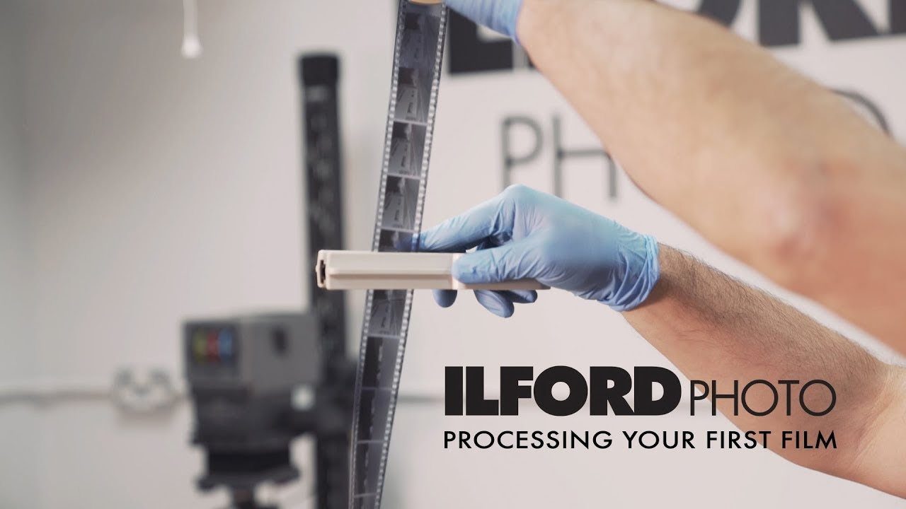

If you wish to squeegee your film, you should do a few things first.
  • Use a good quality squeegee
  • Use the correct amount of wetting agent
  • Warm the squeegee blades in a beaker of warm water with a drop of wetting agent
  • Gently run your finger along each blade to check for nicks or grit.
  • To squeegee, hold the film up high and in one GENTLE movement squeegee the film.
  • The squeegee should JUST KISS the film, NOT GOUGE IT.
But then, each to his own.
(PS. I know this will bring the wrath of man upon myself) 🤓
All those things make sense. But they also seem to be too many things to worry about for most people - and some people will lack the gentle touch required. It's really very simple to hang up the film and not touch it all until it's dry.
Also, a lot of people are getting these things used, now, and the rubber is likely harder than it should be.
And there is also the possibility there is some tiny bit of grit on the film that will get dragged down and score the emulsion. No matter how fastidious you are regarding the squeegee itself, you can't anticipate that.
