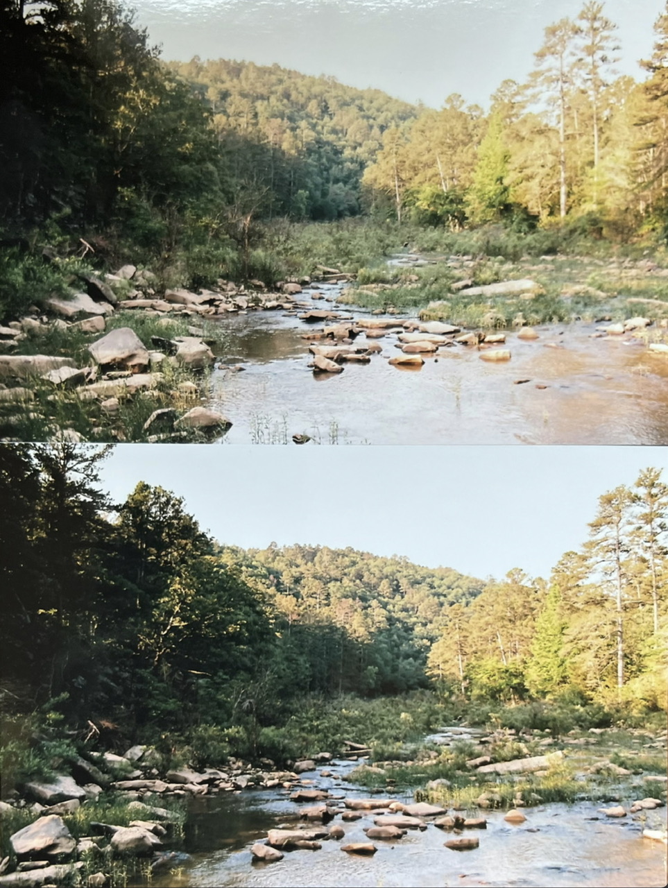

Too much yellow on trees...'

Next time I’ll take a reading from the top part and sky and see what happens…!

I’ll meter the parts that showed excessive yellowing and roll the dice…!

Gosh, I'm glad I grew up the era when people shot color slides. It was a lot easier to evaluate what the camera and film were doing, if you were metering correctly or not, because you could just put the result atop a light box and see it with you own eyes. Now there's a whole complicated workflow one step after another, and if something goes wrong, you have to backtrack all along the way to identify the culprit.
But what you just posted is in fact a mixed lighting scene. A lot of deep blue shade plus some warm open sun. If you or some automated device tries to correct the excess blue percent, due to the shade, it simply warms the entire scene, and the rest comes out too yellow, or visa versa. Although I love Ektar and know how to handle such situations, my advice to you is to switch your film and try something like Portra 400 instead (presuming you did shoot it on Ektar).
The other issue is that you have to choose what is more important to you in the scene. The stream and trees are obviously overexposed. If you lower the exposure, the dark foreground conifers will go black, but that would be less annoying than what you have now.
So yeah, that's a hard scene for an in-camera averaging meter to psychoanalyze. I would have aimed the camera to the right to take the reading, minus the dark portion, use that setting, and then reorient the composition. To me, bold black in the final result would be more acceptable than bleached-out crossed-over yellows. You can't have it both ways at once. But again, you might compare the results of a wider-latitude film like Porta 400.
Good luck! You'll get there.

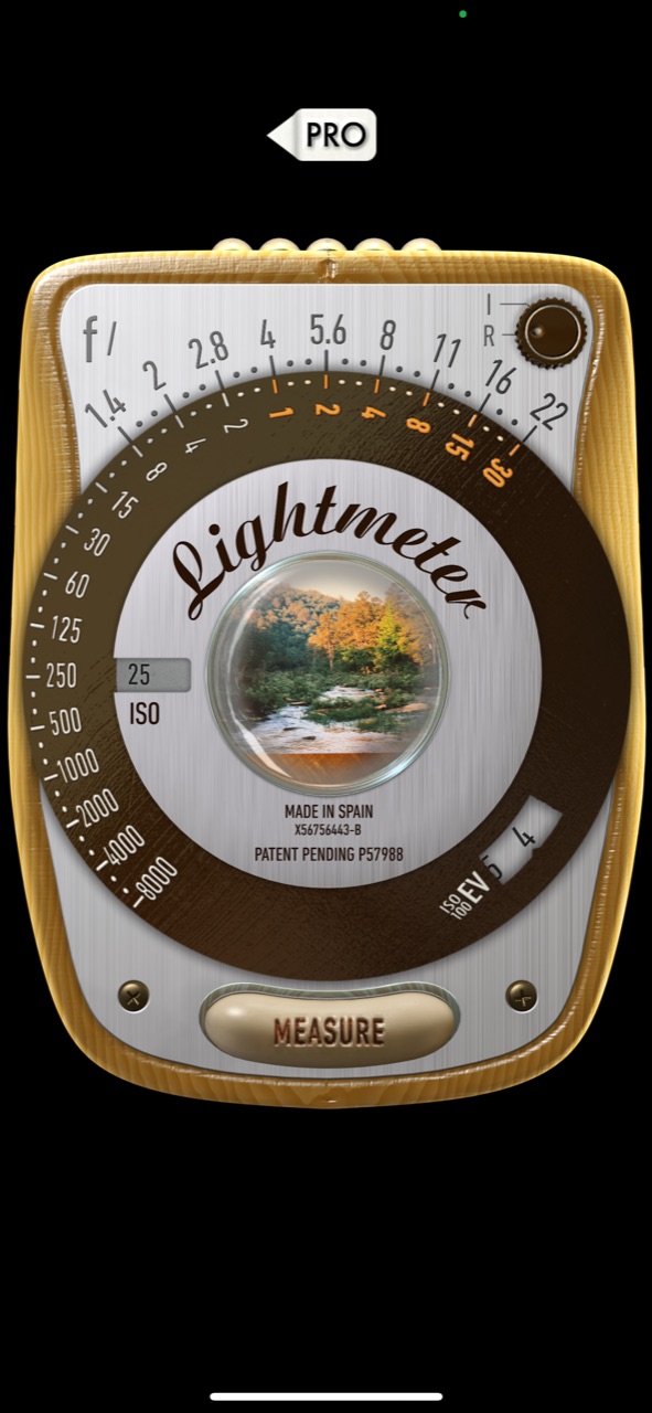

1. I used Ektar 100.
2. Used myLightMeter app to meter.
3. Didn’t use Pro but Classic…!

Realized I stopped down on this shot.
Different day and later on in the morning…!

The technician is right to some degree but when colour printing because there is no way to change the paper contrast of the image what you see is what you get. You can print for the highlights and the shadows will be too dark. Conversley expose for the shadows and the highlights will be too light (which seems to be what happened here). Unlike B&W printing you cannot 'burn' or 'dodge' the print without altering the filtration to counter the colour balance changes that will occur with extra/less exposure. You can get away with a small amount of change but to correct a large shift in tone like that would require some extensive changes of filtration and not via a machine.

What do you mean? You didn't use a wide aperture or you stopped down further from what the meter told you or...?
On the comparison you posted earlier, of two pictures of the same scene, the one you called stopped down looks a lot crisper than the other, so I assume the other was shot wide open. Not a good choice for such a scene. But we're discussing exposure here, and as that's the result of both aperture and exposure time, you could be clearer in what you actually did differently.
It's a fluke most likely. We're looking at phone snaps of prints in some cases and phone snaps of digital edits of scans in other instances, and probably edited scans directly in yet other cases. There's a whole lot going on here that mostly remains implicit and that you have to specifically ask for to bring to light.

I might have shot wide open with either lens on the different photos but I know I stopped down to test bracketing results…!
