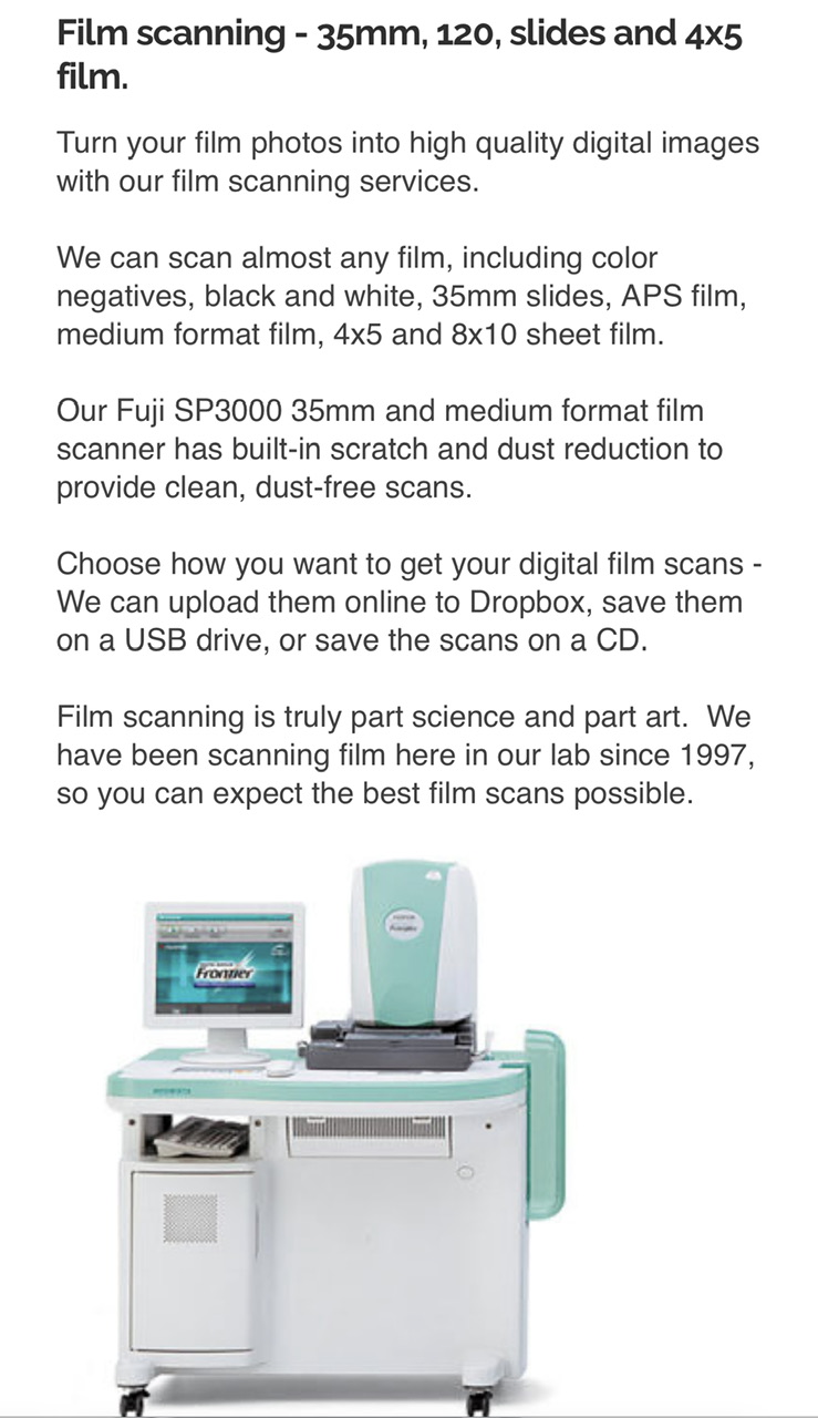

BTW, you still haven't said how your scans were made . . .
The scans were made by Process One with a digital scanner…!
