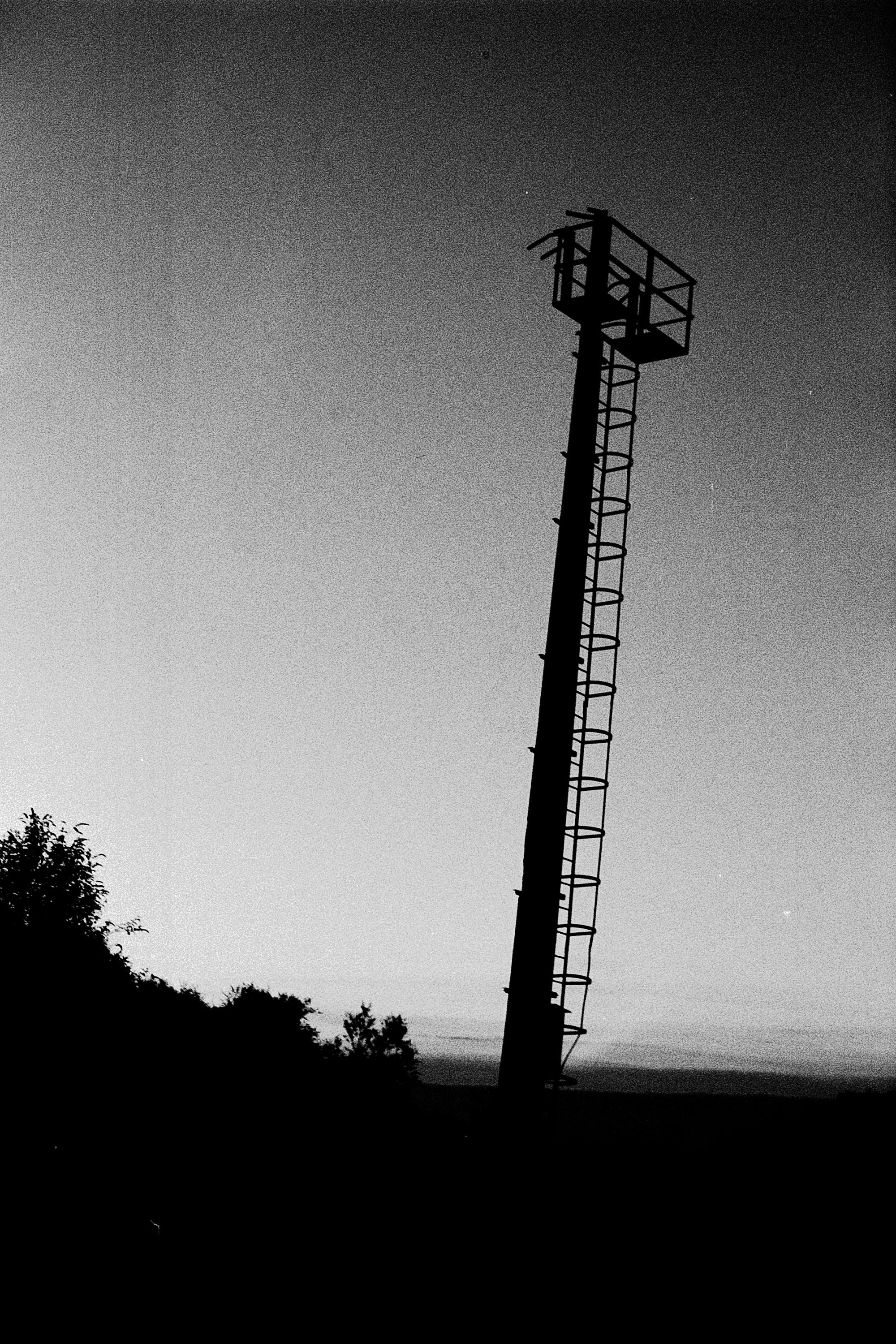

Hi everyone,
Last week I shot a film (Fomapan 400) @ ISO200, which is 1 stop overexposure.
It was during the evening susnet.
Also did i put an Exposure compensation of -2 Stops.
Developed the fomapan 400@ 600 in Rodinal.
Was trying the basic rule" Overexpose film and underdevelop it"
But forgot to underdevelop it.
The photo below shows too much high highlights. Was that caused by overdeveloping it a half stop?
Also the exposure compensation of -2 stops. What effect it has on the picture? Does it create more highlights or darks in the photo in this case?
There's no contrast in the midtones .
I just try to interpret things and understand the photo.
Thx

I see no real highlights on that image - certainly no blown out highlights.
I see shadows instead, which appear to be devoid of detail.
That says to me that you didn't give the film enough exposure.

Hi Mattking,
I think the blacks are heavily black cause it was backlit by the sun, and so it ws difficult to expose. If i would have exposed it more , the highlights would be even higher.
Do you know how much i should have underdeveloped it to get highlights darker?
MattKing
Apr 24, 2005
53,232
Delta, BC Canada
But you don't have any highlights in the image - at most you have midtones.
And speaking more generally, backlit subjects like that should generally be exposed for the background - we expect the foreground to be shadowed.

What were in the highlight? Cloud?? If you print it darker you would have the details if there is any in the original scene. It's the shadow details that are lost.

A back lit picture of the negative would help us.
But too me, it looks as if the camera exposed for the sky.

I think that is why he applied the -2 stops of exposure compensation. He then overexposed 1 stop by derating a stop, but not under developing. This looks like more than 1 stop overexposed.

That is not 1 stop overexposure, rather more than a small underexposure. Foma 400 isn't ISO 400 film, more like 160-180 ISO. Also the film has nasty highlight behavior, so avoid high SBR scenes (that is, scene with high "contrast").
But that is a strange example as it doesn't have any blown up highlights.

Any chance you inadvertently compensated +2 stops while intending -2? +3 stops total would make sense here.

If you rate a 400 speed film at 200 that is one stop over exposure. If you then set exposure compensation to -2 stops you new EI is 800. That is one stop underexposed, that is, IF you believe that Fomapan 400 is really a 400 speed film. There are no overblown highlights in your shot, I suspect your meter was "fooled" by the back lighting and underexposed your negative even more. That said, I like the shot, it low key and moody.

The image posted is what that subject matter usually looks like on film. If you want details in the shadows you would need additional light source, reflectors, fill lighting, fill flash, etc.
Also -2 stop compensation of an ISO 400 meter reading is either exposure index 100 or 1600 depending on the meter or camera. There is no agreed standard.

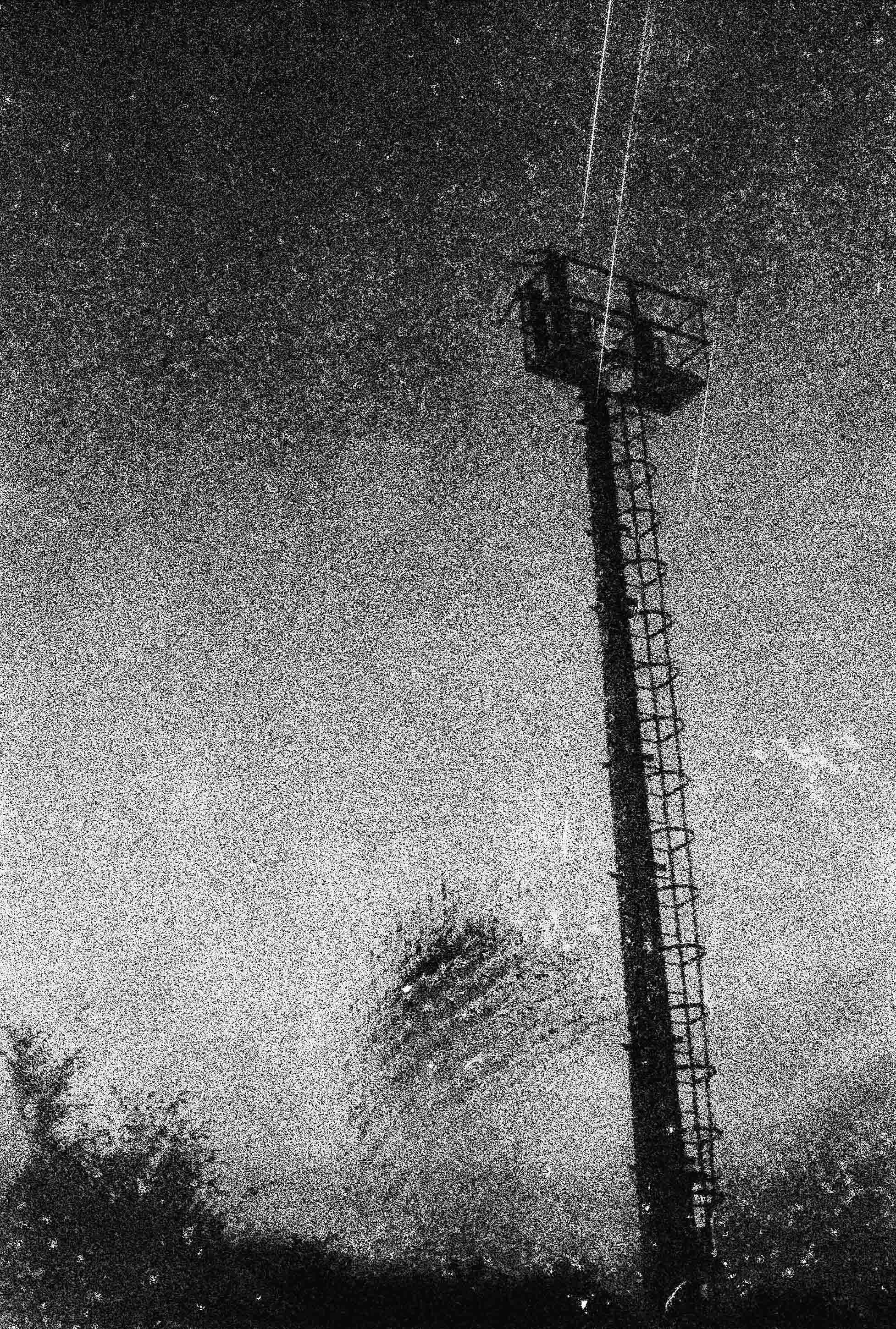

Thx for your appreciation. First i made the image below by accident ,which is even better to me. But the negative was too thin to print it decently.
So i tried to made the same photo , but with non success to me.
