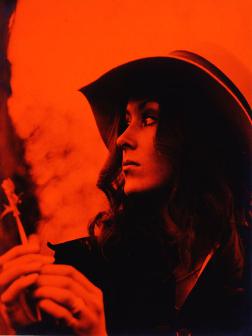

This is a very old image from the early 1970's using food dye, it was on Ilfospeed Matt RC paper.
Ian
