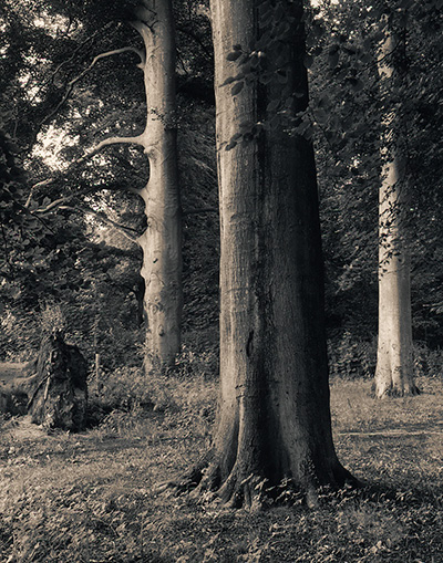

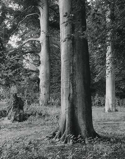

Here is a nice example of what toning, and a double toning of sepia and selenium specifically, can do to enhance the print. Please note that the toned paper was Ilford MGIV FB (not Warmtone), which is one of the paper showing the most pronounced warm brown highlights / cool blue shadows split tone of any current paper. Split tone results on most other papers are less pronounced.
Also note that the sequence in which you apply the toners (sepia first, selenium second, or the other way around), can make a huge difference on the ability to obtain a true cool/warm split tone result. It depends on the paper which sequence works best, and some papers do not show any appreciable cool/warm split tone at all (but will show a beautiful color change when the second toner is applied).
Only a lot of testing (and probably reading Tims book, that I admittedly still need to get myself), can tell what results are obtainable with a specific paper. But don't worry to much, you'll learn a lot along the way by simply starting to tone the prints you make.
