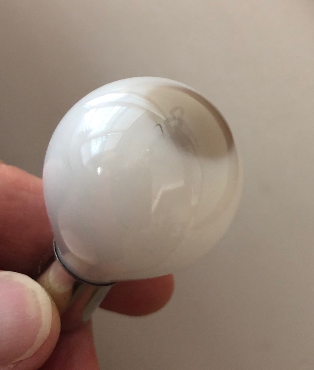

The second lesson came when I looked at some test prints I’d made over the past couple days. They were lighter on the left than the right. I looked at the scanned negatives and they were fine. I pulled the enlarger apart (a Beseler 23C) and found that the bull had lost its internal coating. How long has this been an issue? Probably a awhile. I am (almost) ashamed to admit that I have let this go but I think that since the bulk of my work of recent has been abstract and alternative and much of it has required long exposures, the problem wasn’t that evident. I have an new bulb to replace it and ordered a 6-pack along with a heat absorbing glass (just because.)
Note to self: do those regular maintenance checks on equipment and be sure to turn off the water.
Here’s that bulb.

That bulb burned out on one side. That suggests the socked is off-center. My Durst's socket position was adjustable because they knew some folks (like me) did point source enlarging...which made bulb position critical.
I check the mounting position. Thanks.
