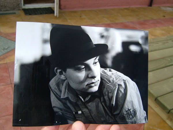

What do you think
27 sec at f11 on Ilford MG, not sure what grade I used but the magenta filter says 80 and the yellow says 30!
Did anybody doubt me?

Great shot. My monitor shows blocked shadows and no highlight detail but that may be what this image needs to sing. Personally I like a little texture in highlights, especially in faces but the shadows look good going to black in cases like this.

Looks good. The fairly high contrast suits the image.
If you look at the info sheet that was inside the paper box (or you can download it from the Ilfordphoto.com site if you've lost it) it gives the different combined yellow & magenta values for each grade for most enlargers. 30Y/80M looks to be about Grade 3 - 3.5 from the data sheet depending on the enlarger. I wrote a small table of the recommended filter values from the Ilford data sheet and taped it to the enlarger (although I usually use the split-grade method these days).

I scanned the print Took a look at the histogram, No blown out highlights (unlike this scan shows) but shadows wern't so good, maybe I should have done 23 or 24 seconds.
