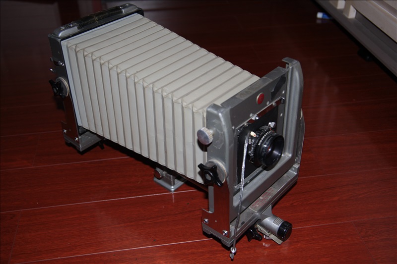

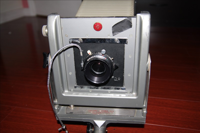

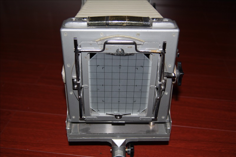

Long story short; I was given this (photo below) with a bunch of other stuff by my local mom & pop film lab. They were offered a sizable sum for the building and property that they ran the shop out of, and were able to sell the business end separately, and are closing shop. They called me up, knowing that I suffer from chronic GAS, and gave me some stuff they weren't going to use.
Now, I've wanted to try LF, and even bought two Graflex's that ended up being garbage. I have 4x5 film holders, and even an old box of film that may or may not be any good. So now I can at least try.
All I know is it's a Calumet 4x5, I believe a CC401, but I'm not sure. Lens is a Caltar II N 150mm f/5.6 on a Copal 0 shutter. Lens is clean (nearly spotless), and the shutter sounds good at all speeds. Bellows looks great, but I haven't light-tested it yet, but I expect it to be fine.
So now for the questions, as I have no experience with large format whatsoever.
When loading the film into the holder (I'll be using a dark bag), how do you know which side of the dark slide is which? ie, the silver side vs the black side? I can see myself mixing them up in the bag, but I figure there must be a trick to it.
Are there exposure compensations that must be made depending on the amount the bellows is extended?
I will be sending the film out to be developed. Do I send the film holders with the film in them? There is a 2% chance I'll develop my own in the future ( I do MF and 35mm now), but in the meantime, they'll go to a lab somewhere.
How do you check a film holder for light-tightness?
The tripod mount seems to be missing a quick-release type plate (or some type of plate). What is the proper name for what I need, and how easily can one be had?
Any other advice would be appreciated.
Depending on the age of the holder one side is black and smooth, the other side is silver or white with raised bumps. Read the top of the darkslide in total darkness like braille text.
From infinity to the lens close focus distance there is no need for exposure compensation as it would be less than 1/3 stop. The close focus distance is usually achieved within 1 1/4 inch of extension from infinity. The close focus distance for a 150mm lens is around 8 feet, a 135mm lens is 6 feet, a 90mm lens is 3 feet, a 210mm is 10-15 feet.
Get some dark bags, http://www.bhphotovideo.com/c/search?N=10015808&InitialSearch=yes&sts=pi , to put your film in and ask for them back. There use to be various sizes available. The bag the film comes in can be used also.

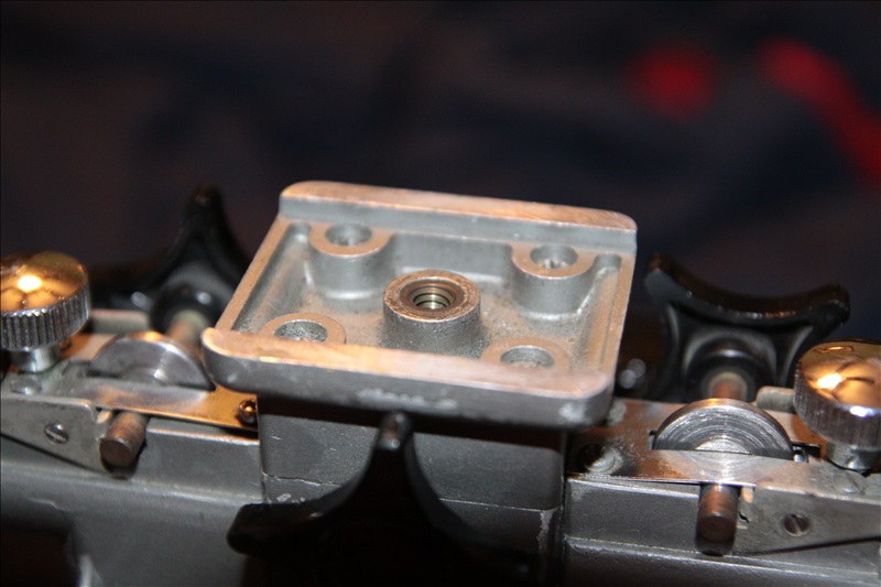

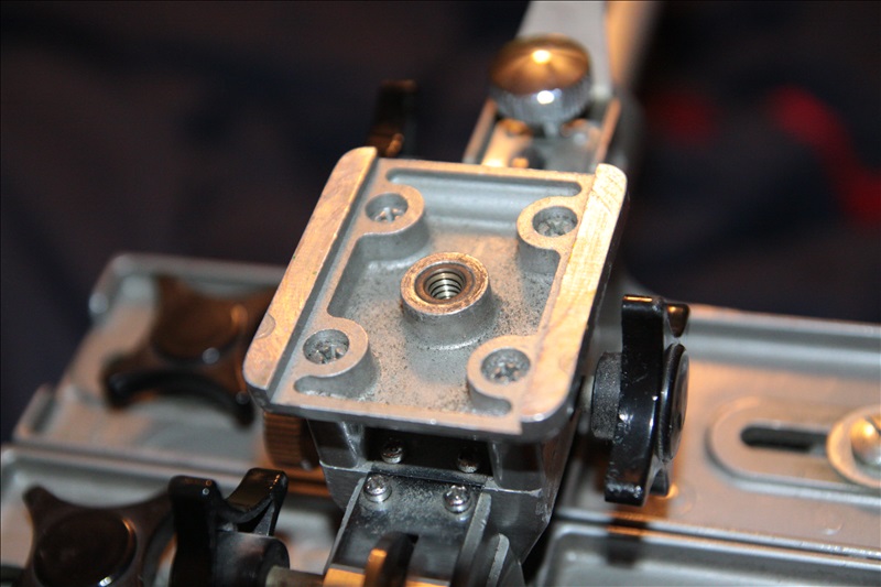

The base of the camera's tripod mount should be flat with a 1/4-20 or 3/8-16 threaded socket in it. Quick release plate and similar is a function of and specific to the tripod head you are using.
Insert the empty film holder into the camera and pull the darkslide. In total darkness shine a bright light into the darkslide slot while looking at the inside of the camera. You should not see any light coming through the slot. Check the film holder for rigidity at the film plate to holder top, any play should be suspect. If more than the sharp tip of a razor blade will fit into a gap between the film plate and holder it will probably leak light.
Sheet film uses notch codes to identify it. When the notch code is at the top right the emulsion side is up.
I was expecting it to be flat, but here's what the bottom of the base looks like:
attachment.php
attachment.php
The receiving threads are recessed, and none of my QR plates fit... :-(

Your QR plates need a longer screw. The screw length required varies by camera and age. The camera may be too heavy for your head and quick release plates. Standard flat surface heads should fit, I'm sure my Gitzo ball head and low profile head screws will reach. Check the weight limit of the head before attaching the camera.
Very similar to what you have: http://www.cameramanuals.org/prof_pdf/calumet_4x5.pdf
