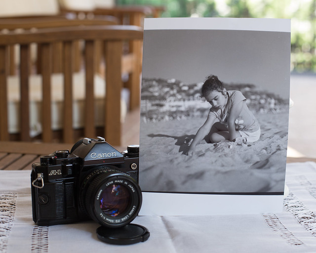

Just an example of my first prints (RC, I'm afraid ... multicontrast Fomaspeed):
And the scanned version:
I'lll try again with another paper (fomabron is the one I use now).
Thanks
Antonio

If you feel the photo you got from darkroom is bit flat, you may try some contrast filters. To my eyes print on RC looks beautiful.

Very nice print, you can make lovely prints with RC, so don't apoligise for it,and it is by far the best paper to learn on, maybe, as Ian says, print some of your best prints on FB paper, as far as the glossy RC paper goses, I never liked glossy RC, for me to glossy, I prefered the Lustre type surfaces, which has a sheen without the high gloss, You will find that air dried glossy FB paper is an entirely different beast, closer to the sheen of RC lustre surface, tghe main thing is to have fun and enjoy you darkroom sessions

Very nice print, keep working at it and try to print the same neg on FB so you can see the difference.

I much preferred the scanned print but I suspect that is down to the way the darkroom print was done rather than any inferior quality of darkroom prints per se. The print looks duller and flatter which might simply be due to the lower grade of paper.
