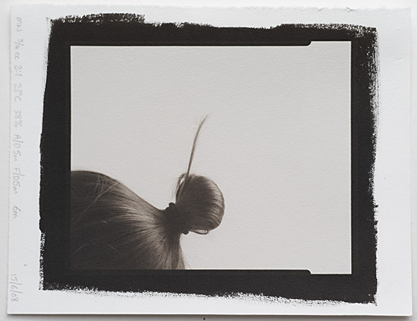

I crop my prints. I don't like visible dark brushed edges for several reasons: they clash with my high key printing, I don't always compose to the edge of the frame (people move especially when in close), and if I'm brutally honest they feel like an affectation or an introduced artifact born out of fear ("proving" it's a hand coated print means nothing if the image is poor; if the image is great then what have you got to prove?). I also think it's pointless using an overmat to hide stuff I don't want to show - firstly because it's still there for anyone to see, secondly because it requires an extremely accurate overmat which doesn't shift to reveal or hide edge details, and thirdly because if the overmat is lost or damaged then you've lost your composition.
I do occasionally use a brushed edge if it's within the film area so the print fades away to nothing without the jarring dark edges. That's sometimes very nice although it's quite difficult to get right.

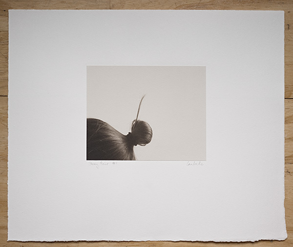

The brushwork is part of the process but the process is only the means to an end - which for me is a finished print. Here is a 'before' and an 'after' JPEG of the print I've just posted in the gallery ((there was a url link here which no longer exists)). The first one shows the print 'au naturelle' with brushed border, etc., while the second shows it cropped and mounted. The two feel very different - in the first one the border imprisons the image and distracts the viewer - but once cropped and mounted the print is liberated and, most importantly, it's finished.

So you cut the image out of the the paper it was printed on? Is that correct? May I ask how you 'mount' it?

Yes, I crop the print and mount it onto a heavier sheet using dry-mount tissue in a press. That way someone can display the print as they wish. Float mounting looks particularly good, but so does a conventional overmat.
