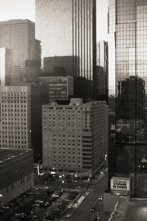

Hi Roger. I shoot it at EI 1600, and process in Rodinal 1+25, agitating full first minute, and then 5s every 30s, for 12 minutes. You need to kick and drag it down the road a bit to get the right contrast. I used it in medium contrast lighting, and this was perfect for a straight grade 3 print for me, using Fomabrom Variant 112 and replenished LPD.
What surprised me, printing Delta3200/Rodinal negs large, was the sharpness and detail available. Nothing short of amazing. There is grain, but you kind of see through it, because everything is so sharp and well defined.
Attached is a lousy neg scan from one of the frames.
Have fun!
Have fun!
I agree with your opinion on the sharpness. When I have used Delta 3200 , it has mostly been on indoor sports events ( I followed my son when he played handball ).
With lousy lighting situations and fast running kids , many pictures turned out quite blurry and that in itself enhances the the grainy feeling. On those few occasions when the motif was still and the focusing and exposure were correct, the pictures turned out to be so razor sharp that you almost didn't notice the grain. I developed mostly in D-76 and in the last years in DDX, but I understand that Rodinal can give even sharper negatives. I have also tried the TMZ and it gave excelent results, but for some , non scientific , reason I have allways been more comfortable with Delta 3200. Whichever film is available to you, use it and enjoy it.
Karl-Gustaf

Thomas is correct on all counts and my vote goes to Delta 3200. Amazing things can be delivered, especially with Rodinal, and medium format is just spectacular. Less grit than 35mm obviously (and which I prefer) but it works wonders for street work/architecture, moody high contrast stuff, etc.
