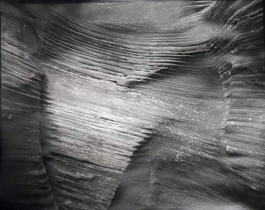

My expansion normally goes beyond that used for silver printing...both my platinum printing and carbon printing requires a greater DR. One feature of FP4+ has that TMax and Acros100 (when it was available), and I assume Delta, does not have is sufficient reciprocity failure. RF is a valuable tool for increasing contrast in low light situations!
When the contrast is much too low for regular expansion techniques for FP4+ (including bleaching and/or intensifying the negative), I go with a higher contrast film. Example below is on Kodak Copy Film (exposed at ASA 25). The scene read from 9 to 12 on my meter and exposed at 10 (f64 at 20 seconds). This film has no listed RF. Devloped in PyrocatHD. Carbon Print.

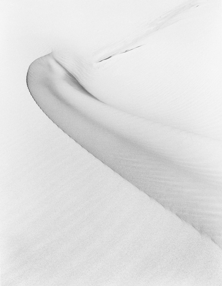

Through the 80s I made enlargements up to 16x20 with 4x5 TMax100, developed in HC-110. A lot of low-light work, but not low contrast scenes. Here is an exception; my Pentax Spot Meter read 14 to 16, I exposed at 15 (f32 at 1/30 sec) and gave a note to develop 50% more than normal. Printed on Grade 3 Ilford Gallerie, selenium toned.
Windpocket, Eureka Valley Sand Dunes, 1991
Now Death Valley National Park
The middle dark streak is blowing sand. Photograph was taken near the top of the Dune...I ended up exposing only one sheet in the high wind, and was amazed it worked.
