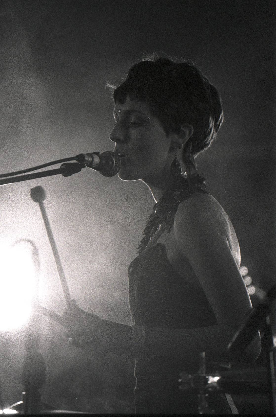

Hi all,
I'm going to shoot some outdoor festivals this summer, there is a little bit of ambient but it's mostly stage lighting. The Nikon F3 does a pretty good job on aperture priority but I'll switch to manual if needed. I'm usually on the limit of what I can hand-hold a 200mm lens with and with movement on stage as far as shutter speeds are concerned. I usually use Ilford Delta 3200 developed in Microphen stock for 9 minutes, i.e. shoot at box speed (3200) develop for box speed (3200). This is fine but the negs are a bit thin and a bit of a challenge to print. On the latest roll I was trying the suggested 'shoot at 1600 develop for 3200' rule of thumb but haven't had a chance to develop this one yet. However, being keen to try the reintroduced Tmax 3200 I bought a few rolls of it and was looking for suggestions on what to expose it for and develop it for - would you suggest the same rules? Expose at 1600 develop for 3200 or even expose for 3200 develop for 6400? Attached is a Delta 3200 example of 'expose for 3200 develop for 3200' this was Microphen stock 9 mins at 20 C. Stealing Sheep (9).jpg

In the kind of night stage-lit shot you have shown, I doubt if shadow detail is very important but what would be useful is a higher zone for her face and to a lesser extent her arms. This may possibly be achieved with greater development and certainly with D3200 I'd develop for 6400 when exposing at 3200( for future reference in case you revert to D3200 ) It really seems to be a low contrast film with a lot of leeway for "over-development". I have had success with it and DDX and have used the develop for the next speed up and even then felt that a little longer development would have been a good thing.
It may be that the above rule for D3200 does not apply to P3200 but if there is a way via development to increase the skin's zone and "whiten" it with P3200 then advice towards that end is what I feel you need. Other than daylight exposure many years ago of the former P3200 and development in ID11 I have no useful experience to offer unfortunately.
Instinctively if it were me, then I'd be tempted to follow Chris Crawford's advice in #4
