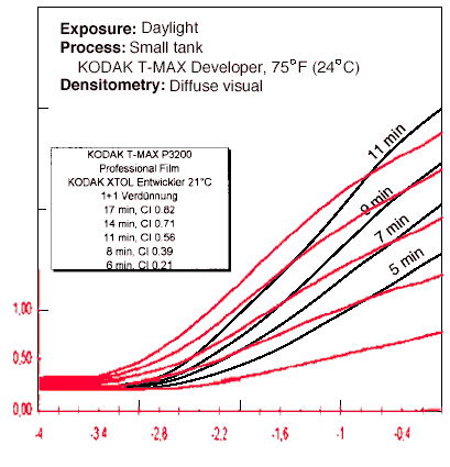

Here is an overlay of Kodak's curve set of Xtol 1+1 (in red) over the Tmax developer curves.
It shows pretty clearly that Xtol (1+1) gives a higher shadow speed that TMAX,
which translates as shadow detail. You can find the Xtol data at:
http://wwwfr.kodak.com/AT/plugins/acrobat/de/professional/xtolEntwickler.pdf
The curves are at the end of the document.
D-76 1+1 will give the same speed as TMax developer, but a less contrasty image. Look at the TMZ pdf from Kodak to compare D-76 and TMax developer.
