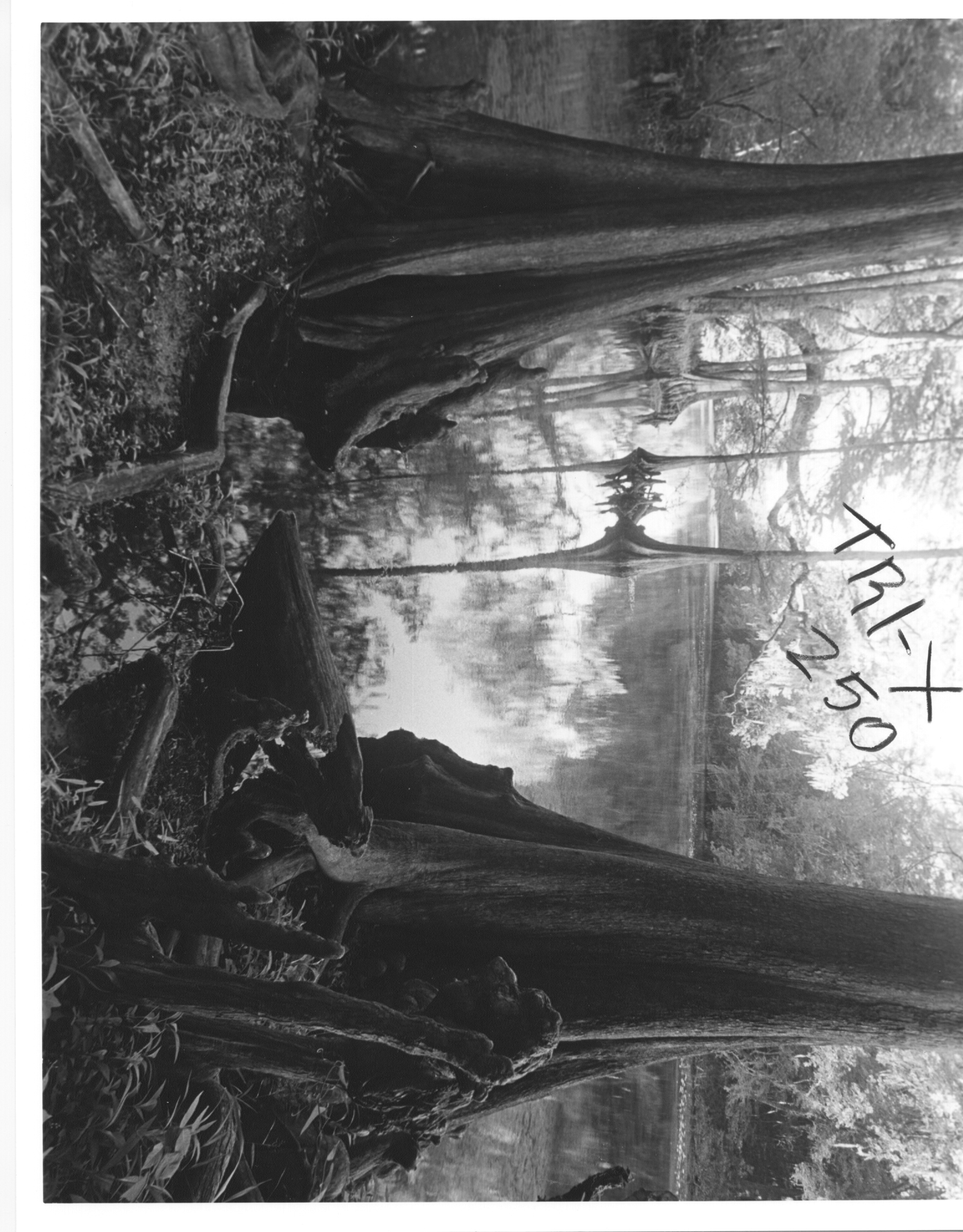

Just like with the Ilford Films, I decided to subjectively compare Kodak TMAX 400 and TRI-X 400 at box speed 400 ISO both. The difference this time is that TRI-X was processed on D76 1:1 and TMAX was processed in TMAX Dev at Kodak recommended specs.
Of course controlling all the other possible variables as better as possible, I shot the same scene or subject with little time apart and developed both rolls (35mm) within the standard parameters. When Printing (see attachment), I also printed on to the same type of paper and developed exactly alike (Dektol 2:1) to avoid introducing more variables. To be honest , the Dektol on the tray was starting to lose its clear look because I had been sitting out for many hours. but were printed minutes apart so both are affected by the same variable.
The following are my subjective findings and I would like to ask out there if they are in sync with the scientific difference between these films.
- I found TMAX 400 to be more contrasty than TRI-X 400
- I found TRIX to have coarser grain than TMAX . TMAX grain is finer rendering what it seems sharper prints.
- I found TMAX to be less tolerable to high contrast scene than TRIX (this of course taking in consideration that both were develop at standard specs. in its respective developers.
- I have the impression that TMAX produces sharper print, probably due to finer grain.
- TMAX scans better than TRIX . No ICE, clean or sharpen functions were applied. They were scanned off of the paper final print.
In the nature print, look at the lower left bottom corner of both prints. Look how the TMAX is more contrasty rendering that vegetation more attractive.
thank you for your comments.

Thank you for your effort. My respect you have done it APUG way, on prints. I just can't "read" it, I can't rotate monitor. Why here is 100 at one of the print?
To me TMAX is lifeless film. And TRI-X is the best, but it is rich people luxury I can't afford :smile:

If I develop two films to the same level of contrast, what difference characteristics am I looking for then ?
Dali
Jun 17, 2009
1,875
Philadelphia
Micro contrast, general tone, accutance, effective speed, apparent grain shape and size. you name it....
To me, Tri-X is a reference film, because it can stand under and over exposure pretty well and it suits my needs. Just my 2 cents...

Out of curiosity, why did you use two different developers? Both developers and films are designed to be used with each of them.
lhalcong
Nov 26, 2012
245
Miami, Flori
I shoot basically two type of subjects. Nature and People. (Keep in mind though that I am speaking subjectively), I feel I like TRI-X on D76 better when shooting nature and I feel I like TMAX on TMAX Dev. when I shoot people. Again; I am going by what my heart feels is better. So at this time I wanted to test my choices against each other's type of subject which I had not done before with the same exact scene. In other words, I wanted to feel how TMAX on TMAX Dev looks on Nature vs. TRI-X. and then I wanted to see how TRI-X compares to TMAX team on people. Again , with exact same subject and conditions. Makes sense ?
I could take it further and compare film to film on same developer or dev. to dev. with same film, but then again the combinations of films/developers would be almost endless. I heard trying to do this would be a futile effort not to say the time and resources required to do such thing.

I have absolutely no interest in this "test" since not the same developer was used. Kind of pointless...
Agree. Fun test if you have fun testing things but all assumptions made at the end could have been easily reversed with differently applied exposure and development technique.
And this idea that a film is sharper because it's finer-grained is puzzling me. I find the opposite most times at least in "perceived" sharpness when viewing a resulting print at normal/typical viewing distances.
Interesting.
I completely overlooked the word "subjectively" in your initial post in this thread ("I decided to subjectively compare Kodak TMAX 400 and TRI-X 400 at box speed 400 ISO both.").
I would guess that I wasn't the only one, because so many of the responses were to the objective characteristics you referred to.
Although it would most likely have helped if you had included this post in your original one.
Lesson learned - one should read the post before responding.

These two films are VERY different. You spotted some of the differences already. But I would argue that TMY400 is capable of a longer contrast range if you are willing to correctly meter the shadows. You don't need to overexpose it to get good shadow detail like people have
traditionally done with Tri-X.

There's nothing wrong with testing two different films in two different developers. The problem here isn't that the TMY is more contrasty in T-Max developer, but that the two films haven't been developed to the same contrast. You have a starting point with the first test. The best way to determine the contrast between the two films would be to do a sensitometric test, but you can also just reduce the TMY development time and retest until the shadows and highlights fall at the same point. The goal is to have two films developed to the same contrast so you can evaluate their characteristics.

Despite the problems with the testing protocol, this post was very informative for me. I have always liked the look of Tri-X better than TMAX, but I had no idea why. From my usual assumptions, the finer grain and long, linear scale of TMAX should be better. This test showed enough to give me some hints. First, Tri-X is more forgiving. Although I have over 60 years of experience, and I know and more or less apply all the right rules, I'm still basically a snapshot photographer - I tend to concentrate on the scene a lot more than the camera. Forgiveness helps. Next, Tri-X is less likely to block up the highlights. With even decent metering, you can usually, but not always, avoid very high contrast situations. Sometimes you can adjust development. But when the highlights block up, even in a very small area, the picture always looks terrible. And it usually can't be corrected in printing. Tri-X is easier to work with here. Third, the microcontrasts in the shadows look better to me. Again, the overall lower contrast seems to help.
Nathan King
Sep 27, 2013
248
Omaha, NE
My experience has been the opposite, though I don't have near your experience level, so I could be off base. I'm assuming you developed both to the same contrast at grade 2? T-Max has always held highlights longer, and those highlights burn easier because the contrast hasn't tapered off. I do really like the spectral response of Tri-X though. I have a huge print above my fireplace taken with 35mm Tri-X that looks amazing.
nworth
Aug 27, 2005
2,228
Los Alamos,
The long scale of TMAX 400 indicates that it should hold highlights better. But the examples in this thread seem to show otherwise. Because I was somewhat unhappy with TMY, I don't have a lot of experience with it. Looking at my few negatives, it wasn't a bad problem for me, although there may be a few spots. I try for consistent development to about the same contrast, but I do little enough work now that it doesn't always work. Some of my TMY shots were 8X10, which calls for a different development scheme altogether. (I used D-76 in a Jobo tube.) I wasn't either real happy or real disappointed with that work, but I didn't think the negatives looked terribly good either.
