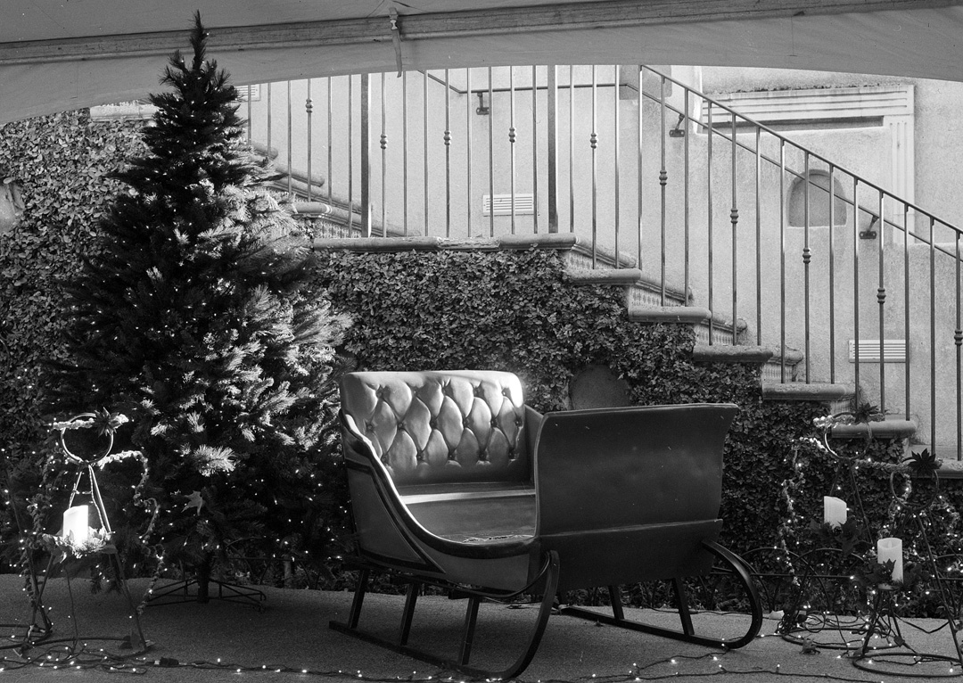

Jaun... thank you very much for your explanation. We rarely push or pull film but the image we were trying to capture, without tripod is the one below.
awaiting-santa-jpg.293036
We shot it at 1600 and processed it normally, and it seemed to come out quite well. The sun is hitting the Santa's seat and the candle. We cropped the image where the sun highlighted the floor area to bright. . So as you stated: "So at 1600 your soft light scenes will have normal tone with some shadow loss .."
We shot it at 1600 and processed it normally, and it seemed to come out quite well. The sun is hitting the Santa's seat and the candle. We cropped the image where the sun highlighted the floor area to bright. . So as you stated: "So at 1600 your soft light scenes will have normal tone with some shadow loss ..".
Looks pretty good to me and if there is shadow loss here I can't see it other than what seems normal for shadows in such a scene
pentaxuser
Your scenes are close to perfect. Have you seen what you get printing them in the darkroom? That's the real game... Scanning is a virtual adventure.
