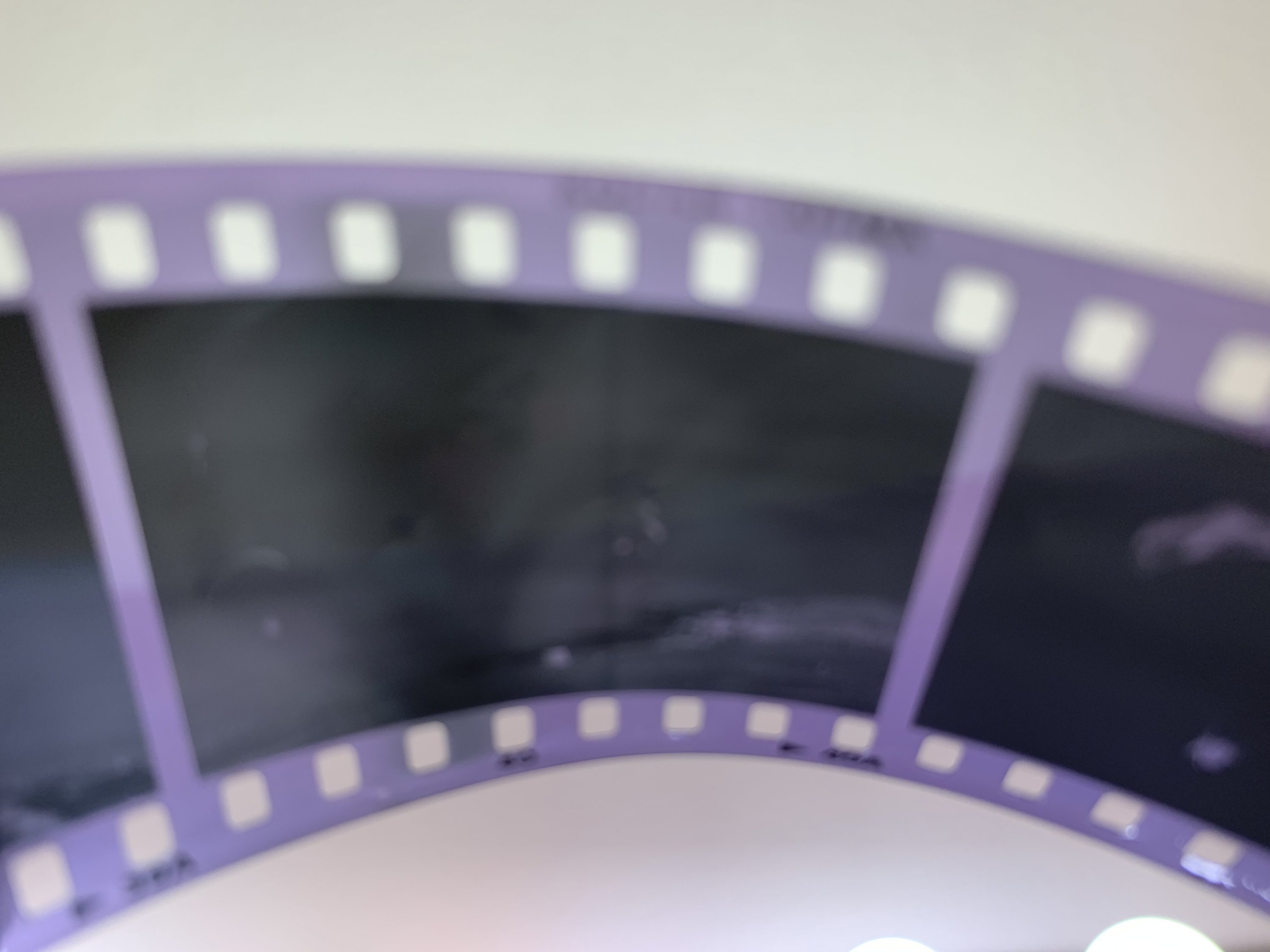

HELP!
Processing TX100. Everything went normally - Drum on a Uni-roller with constant agitation, developed in D76, stop, fix for 10 minutes, HCA and more-than-Ilford-method rinse (3 min, 3 min, 5min, 10 min). But purple kept coming with every rinse dump, and when I opened up the first reel to put the film into distilled water with PhotoFlo, the whole film was still very purple.
What now? More rinse? Could fixer be exhausted? This gallon has done 45 rolls.

Beret what it looks like.
Lachlan Young
Dec 2, 2005
4,945
Glasgow
Yeah, that looks underfixed I think. Working strength rapid fixes have about a 1 month lifespan in a partly full bottle, about a week in a tray.

I've noticed the effects of pH that Ron mentioned - C-41 fix takes most of the dye with it (makes for spectacularly pink or purple fixer) while the more acid rapid fixes don't. For whatever reason, I've found Tri-X to fix much better/ faster in C-41 fix than more acid fixes.

First, a correction to the OP - it was a purplish deep blue, not a real purple. All chemicals and rinse/mix water that I use are put together at least 24 hours before and so are all the same temperature. The fixer was regular Kodak Professional Fixer, not rapid. The data sheet says it should be good for 100 rolls when stored in a closed full bottle, which this was, but it looks like it went beyond the 2 month storage time. Luckily, I had a quart of Ilford Rapid Fixer working solution that had been used on a few 4x5 sheets of HDPP. It was only a quart and the film was in a 2-liter tank, so I diluted it 1:1 to cover the film. Because of the questionable strength I let it run on the roller for 30 minutes.
Pouring it out, there was a lot of blue.
This was followed with 4 rounds of rinse in 70 degree water at 5min, 10min, 15 min, and 30min. The water dumped out pinkish blue, pink, less pink, and finally clear. This morning, now dried down, the films are still a bit blue, so I re-spooled and will run them back through a fix and rinse as soon as I mix up a new batch.
The first New Year's resolution I have made in 25 years was to put an end to my Vivian Maier-like backlog of undeveloped film. That's when this fixer was mixed and it got me about halfway there.
Was it the fixer mixed from powder, or the liquid fixer that comes in a single one quart or one litre bottle?
The latter is actually a rapid fixer.
Both are hardening fixers, which might also have an effect.

I had a similar, perhaps the very same, problem with TMY in 4x5 a while back. I had three or four 50-sheet boxes that came out blue no matter how long I fixed, HCA'd, etc.
If you have the same issue, it's not your fixer and it's not your HCA or lack thereof. It's a problem with the dyes in the film (sensitizing dyes I would think, not the anti-halation layer).
The remedy was to soak the film in a mild alkaline solution after fixing. I used both sodium carbonate and bicarbonate (baking soda) as well as some others. All of them worked, but I ended up using the carbonate most of the time since I have it on hand. It was something like 1/4 tsp in 500ml of water.
The blue tint rapidly turned to brilliant magenta and infused into the solution. When the film base was clear, I washed as usual. This became part of my "normal" TMY processing for 200 sheets or so. After that, the next batches didn't need the extra carbonate bath.
I have no idea what caused this; neither did anyone else here. I posted about it along with photos and got zero responses... It appears to be fleeting.
At any rate, the alkaline bath worked fine and the negatives turned out very clear and clean.
The powder that makes 1 gallon. Yes, with hardener.

Did it fizz up at all? If not it should be easy enough to try this in the tank where the film is all ready to go.
Not really a good choice with modern high iodide emulsions with the electron sensitisation dyes - a near neutral pH ammonium thiosulfate fix is what's really needed, not a fairly acid sodium thiosulfate one.
