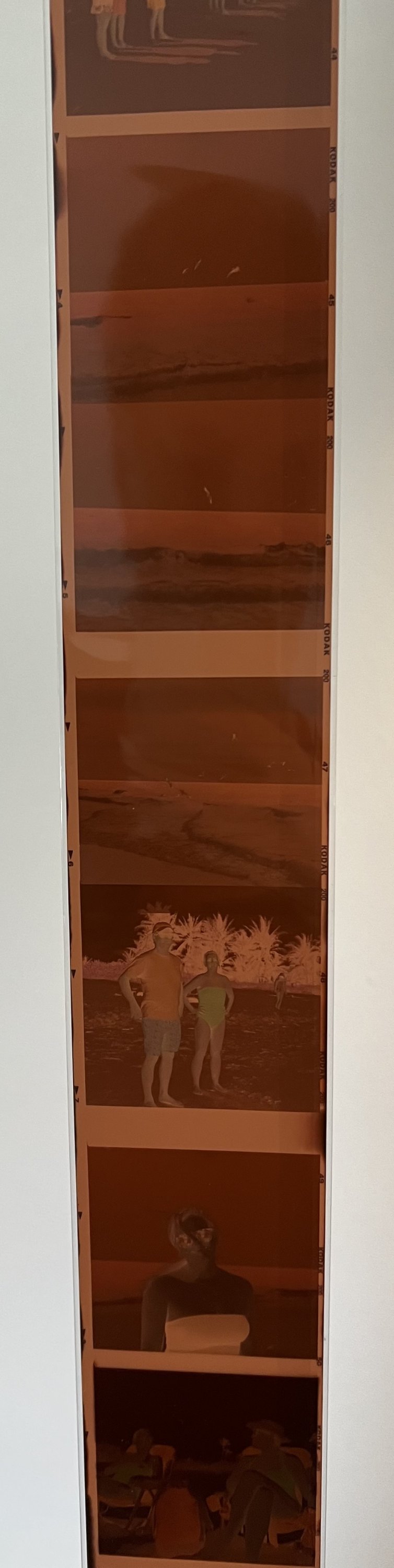

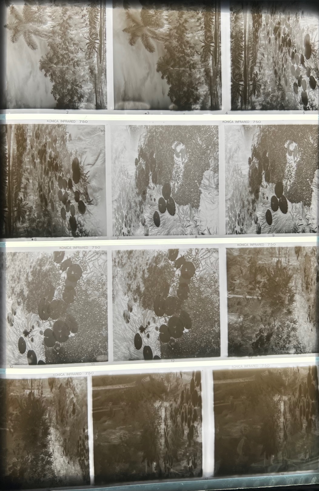

Posting some pictures for context. The strip of color negs is the roll of Gold in question. Most are OK, but frames 4/5 and 6/7 have overlap (especially severe on 4/5).
Strangely, however, the spacing on a roll of Konica IR a shot just a few days later is fine.
Maybe I just didn’t turn the advance crank with enough authority?

I'm seeing two things on the Gold 200 negatives not previously covered. The image is not centered on the film, wide rebate on the left, narrow on the right. There are dark spots along the edges in various places on both sides. These suggest the film was not loaded properly.
With the back open, interlock set like the back is closed, 1. with an empty spool in the supply, turn the spool with your fingers using as light of pressure as possible. Does the spool turn smoothly and even pressure throughout the turns? 2. place the spool in the take up position and turn the crank, trip the shutter, turn the crank. Apply light to medium pressure on the spool while operating the crank. Does the take up turn smoothly and evenly?
