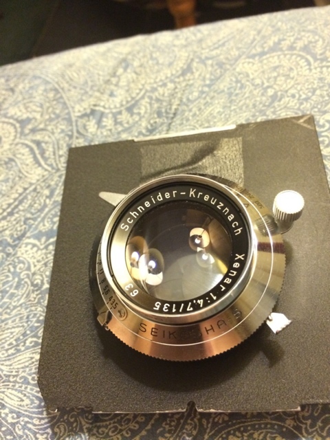

Matching the lenses would be a headache though. I've got a seikosha s shutter that I assume was ripped out of a mamiya tlr lens set. It currently has a 135mm 4.7 xenar in it mounted on a linhof/wista board. It works fine, it's just without a cable release socket (can be solved with one of those recessed boards with the built in angled release I guess) and without a flash sync pc or bi post connector only a wire coming out of it(quite ugly). You also have to worry about if flange distances between the cells is enough for the lenses you put on, as they may fit but may not focus, hopefully only requiring shimming with paper. Maybe someone else has done this before you and can comment more. ImageUploadedByTapatalk1417081504.588145.jpg

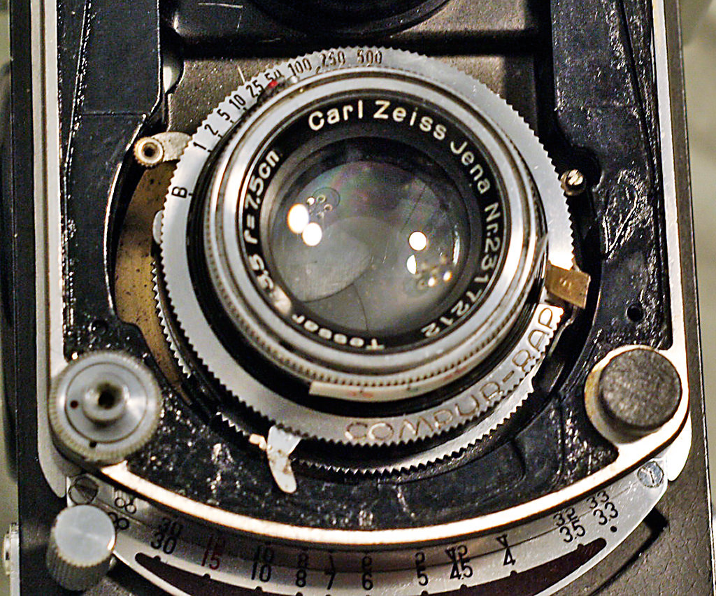

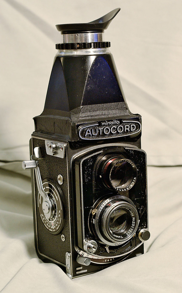

I installed a Compur #00 shutter on the front of a Minolta Autocord and then mounted an old Tessar lens from a folder. The lens had speed and aperture markings, and I was able to align the shutter with the release mechanism of the Autocord body. I didn't even bother with the lens shroud- the chance of the aperture and shutter dial mechanisms aligning with another shutter was pretty remote. I had to manually cokc the shutter after each shot; the wind mechanism worked fine, and using the Autocrd's mechanism engaged the wind lock/release system.
I set the focus with the Autocord's viewing lens to match at five feet. I figured that depth of field would put me close enough for most distances and smaller apertures.
Remember that the lens shroud is for convenience and decoration, not function. Most TLR shutters that I have seen have only dots for shutter speeds and no aperture markings on the shutter block itself; a little work and you can make your own scales.
The only TLRs that I am certain use #0 shutters are the f/2.8 Rolleiflexes. If you skip the lens shroud, you could most likely swap in your Tessars. But these cameras used an 80mm lens while most free-range Tessars I have from folders and such are 75mm? I did mount an 80mm Xenotar from a Rolleiflex on a #0 shutter and an use it for shooting 6x7 on a Horseman view camera, but that's not the direction you want to go, I guess.
