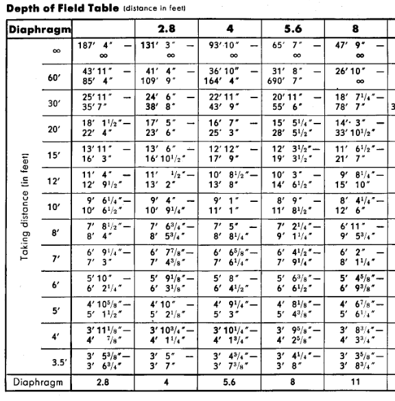

Along with what everyone has said, be aware of another issue with waist level finders, re-framing. After focusing with most any camera people will often fine tune their framing. This can be because they moved the camera to put the object they wanted in focus at the center for ease of focus, or simply because of final adjustments before hitting the shutter release. With a camera held to your eye, these kind of adjustments can be done with minimal movement. But with waist level finders, the camera sort of floating out there away from the body a bit, it can be easy to re-frame by moving the whole upper body in and out... and possibly lose focus. For most shots this won't be a real issue. But close up this can lead to focus changes. And with faces, we are very sensitive to eyes being in focus so small shifts can ruin the final shot. So practice focusing close and re-framing without moving the upper body back and forth. Use hands and arms only, and be prepared to check focus if you have moved any significant distance back or forth. Significant for an 80mm lens wide open meaning 1-2 inches.
This chart is from a Rolleiflex manual but same focal length. At 3.5 feet, even at f/8 there is less than 3 inches depth of field front and back, 6 inches total (the lower aperture numbers are for larger enlargements).
