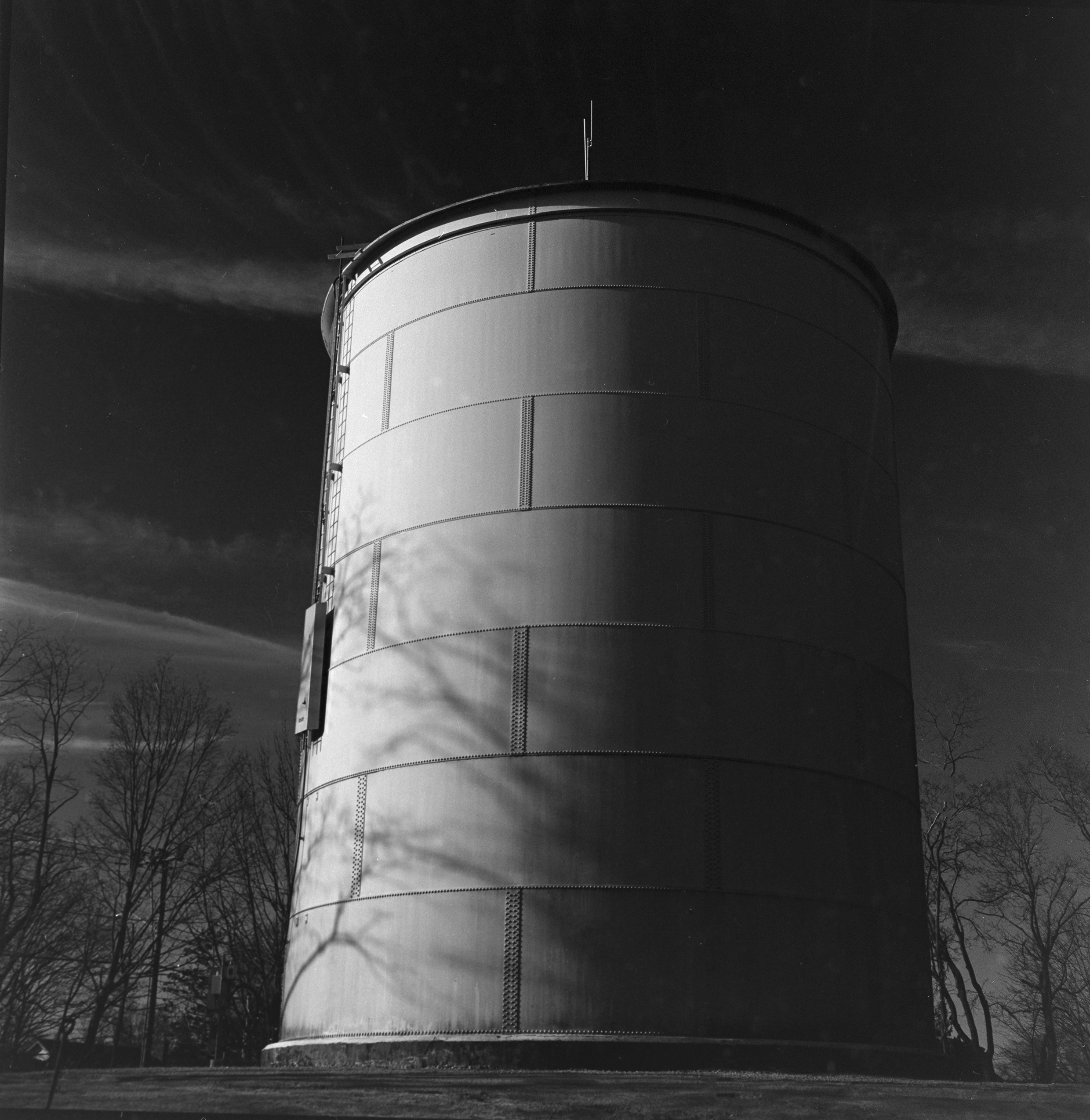

+1. Recently snagged a 'Cord Vb(ii) in mint condition, and it's a wonderful camera. A little more work than the equivalent Flex, but I like that. But its optics are still tops and it's much lighter. Can't go wrong with either Cord or Flex, such brilliantly designed cameras. This from the Cord shows the sharpness of the Schneider lens. Red filter. Tri-X in Pyrocat HD

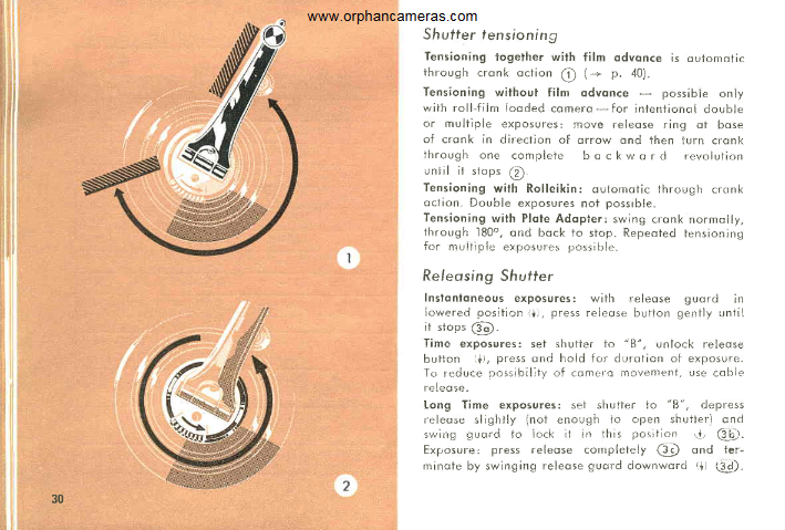

On Rolleiflexes, you need to look for the serrated section at the bottom of the ring around the wind knob, with an arrow engraving. Pretty much every post-WWII Rolleiflex has this feature, but maybe the K4A is missing it? Not certain. Reading this page, it says that double exposure is not possible with the Rolleikin 35mm adapter system.
All in all, if double exposures are your thing, a Rolleicord is the best bang for the buck. Double exposures are simple, lens is great, 35mm using Rolleikin is possible (with double exposure, I am almost certain). The Rolleicord IV (4) is the first with double exposure prevention (with lever to allow double exposures). Rolleicords are not crap versions of Rolleiflexes. They are 'simpler' versions! It's the Yashicas which are the crap versions of Rolleis... oh oops, I didn't say that! (condition, condition, condition!)
('tensioning without film advance' means recocking the shutter without moving film, making double exposures possible)

+1. Recently snagged a 'Cord Vb(ii) in mint condition, and it's a wonderful camera. A little more work than the equivalent Flex, but I like that. But its optics are still tops and it's much lighter. Can't go wrong with either Cord or Flex, such brilliantly designed cameras. This from the Cord shows the sharpness of the Schneider lens. Red filter. Tri-X in Pyrocat HD View attachment 307083
Beautiful shot. And your cord can do double exposures?

Appreciate the info. The image you attached is for Rolleiflex not cord correct? So rolleiflex can't do double exposure using 35mm adapter. That's interesting I'm curious what prevents that; is it just the crank difference?
Well based on this it's looking like I might be looking for a Rolleicord since you're saying you can do double exp with adapter. Just to confirm, when you say the Cord IV is the first that has the prevention, do you mean the IV and later ones can't do it or the IV and later ones can do double exposure?
