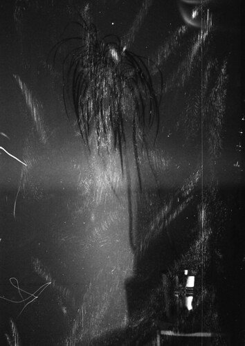

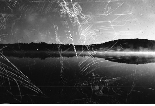

I use Ilford Rapid Fixer without hardener, Ilfotol and hang my film to dry and yet I still manage to ruin my Rollei 400S. My Ilford and Kodak are fine unless I have a really tough time loading the plastic reel. Might try steel instead for the 400S to see if gentler loading helps.
Yes, I recently had to quit squeegeeing my film as I noticed I was getting long scratches on film. I thought it was the film holders but then I noticed I had a burr on the squeegee... no more. I thought the photoflo streaks would show in printing but they didn't.

Harry, I have never seen that happen from spools... . those are some nasty scratches.
