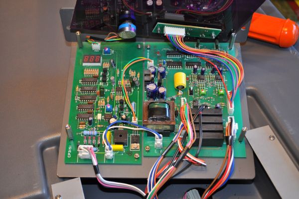

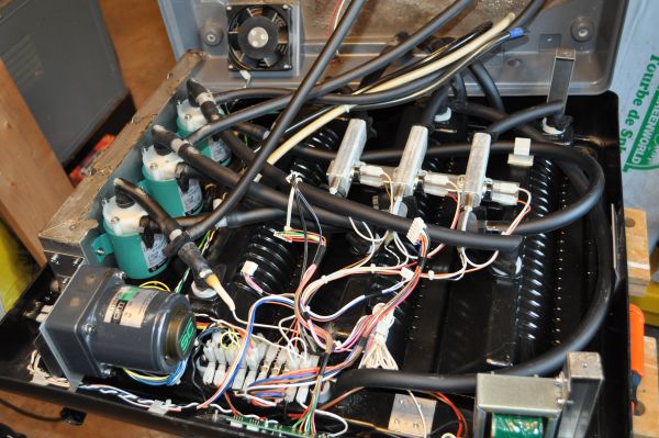

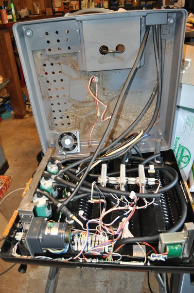

I've gone as far as taking the bottom off. Sounds like you took out the screws from the top side. Put them back, remove all the racks/rollers. Disconnect the plugs on the circuit board. Then flip the whole thing over. Take out the screws on the bottom and it should open up. There is a connector by the fan which you'll have to get as well.
The spray rods might need to be cleaned, I found a bit of debris in mine. The pumps do need to be primed - if your leak is letting air in before the pump it would stop it from pumping, best not to run it long this way. If I recall I had to reset the control board to get the first bath temp control to work.
It should look like this:

George, thank you! Flipping it over and removing the bottom screws did the trick. It comes apart quite easily that way.
I found my leak, but there still seems to be something wrong with the pump for bath 3.
After I got the bottom separated from the top, I carefully flipped it back over and used some bricks and boards to raise the top black bath section up above the grey bottom shell a couple of inches. I filled all three baths. I used the priming funnels, as per the instructions to prevent air lock in the pump.
I saw my leak even before turning on the power. It's in the bath itself, not in one of the tubes. The step-down transformer in the lower right corner of your first and third picture has a white plastic part perpendicular to the windings. Each of the four corners of the plastic plate come to a curved point. The transformer twisted on its mount and one of those plastic points pressed into the end of the molded tank and put a hole through it. It was probably a casualty of shipping.
