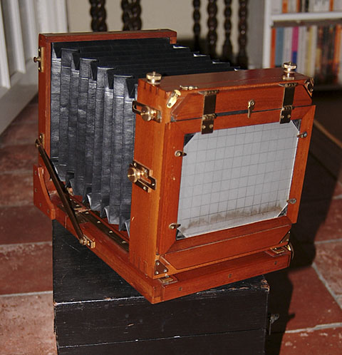

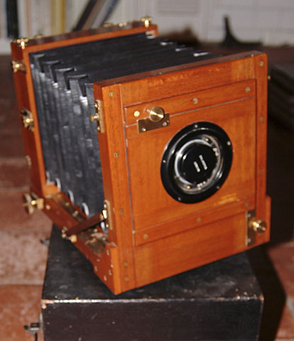

Can you post a jpeg. of your camera please, just out of interest? I have a Gandolfi whole plate camera (for shooting film).

Here it is, I've attached a front and rear view.

Oh! It's a Universal. I have the 12x15 version of the same camera.
Roger, glad to hear that I'm in good company! Do you know much about these cameras? My father was given this one when he left his first employer (he was a scientific instrument maker, served his apprenticeship there and went on to be a senior manager before leaving to set up his own company). I don't know much about the camera's age, history, possible accessories, etc.
Any information would be of interest.
Thanks
Barry
