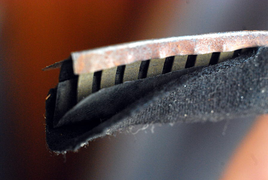

I have several 5x7 film holders which need the felt light traps replaced. Could someone give me some tips on how to proceed?
These are old Kodak and Graflex wooden holders, so easy to access light traps by removing four screws.
The felt is wrapped around the brass spring material (along with a protective plastic? strip) then crimped by the tight fold of a metal strip. As you can see in the attached photo, when using a small flat head screwdriver to pry apart the fold I create small indentations in the metal. Hmm... that doesn't look like it will be easy to crimp back flat and tight.
So what kind of tool(s) do you use to properly open and reseal this crimp/fold that holds the felt in place?
Also, I've read that some folks use adhesive to glue the felt in place... if that's advisable, which type of adhesive is best? One person commented that some adhesives will off gas or leave an oily film that can possibly damage film.
Also, recommendations for exactly what type of felt and source for such?

As someone elsewhere has suggested, I'm going to try just pulling the existing trap out of the crimp then use a wide flat blade to pry it open for reinserting the trap with new felt. It seems like a simple procedure, but the proper tools and technique will be important to make it smooth working- so I'd appreciate any input from folks who have experience doing this...

Felt from Joann's or hobby store http://www.joann.com/12x18in-felt/zprd_02404655a.html#q=felt&start=3 or http://www.michaels.com/black-felt/MD004741S.html?dwvar_MD004741S_color=Black#q=felt&start=20
Spread the finger stock open with a 1 inch or wider wood chisel. Press in with the angled side facing the side of the finger stock you want to bend outward. Crimp with the smooth section of large needle nose pliers.
