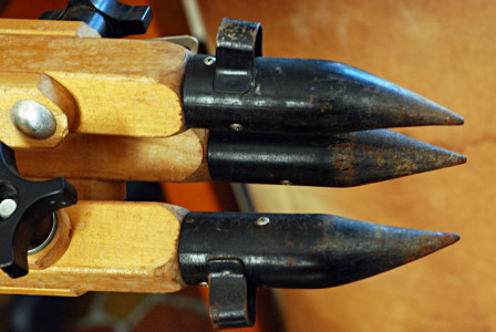

I recently bought an old Zone VI heavy duty tripod to use with my 5x7. Although my main intent is to use it outdoors, I sometimes want to use it indoors and I'm wanting to find a convenient solution to covering those spikes (temporarily on demand) so they don't damage any of my floors.
Anyone have experience making or buying removable caps for these things?
Thanks if you have some workable ideas...
Keith

The rounded part is about 1.25" in diameter, and the tapered end is about 2" long.

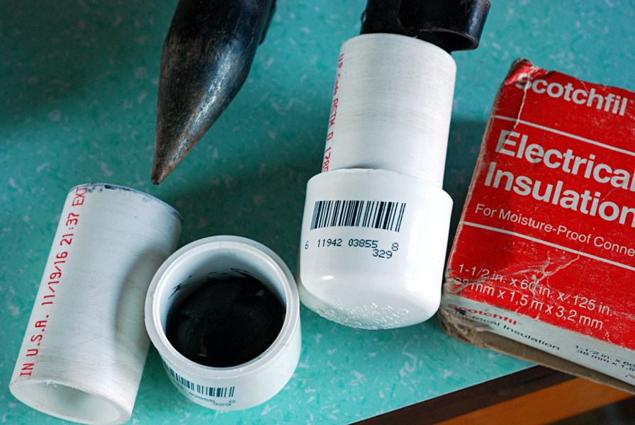

OK, here's my current solution:
I bought some 1.25" dia PVC pipe and some caps to fit. Cut the pipe to 3" lengths.
I happen to have some old Electrical Insulation putty, a kinda soft never drying stuff that I used to use outdoors around antenna junctions and such. I put a glob of that stuff into the cap.
Put the cap on the pipe, fit the pipe over the end of the spike until it stops. Voila!
I needed to figure out how to both keep the cap on and be able to remove it easily. I could drill a hole in the pipe and run a string/wire between it and the spike... but the electrical putty both holds the cap on and steady, and allows it to be pulled off easily. The pipe is stopped by that metal loop near the top of the spike- the spike doesn't actually come in contact with the PVC cap.
The PVC caps are slippery on wood floors, but fine on linoleum. I'll probably glue some rubber on them when I find the proper glue.
BTW- I did find some of those old cane tips, but they were way too small. And I could have used large copper pipe caps... and may still try that.
Thanks for all your suggestions!
Keith
Keith
Good idea. Now wipe them off with acetone and paint them black, maybe even put some self adhesive felt floor glides on the bottoms.
