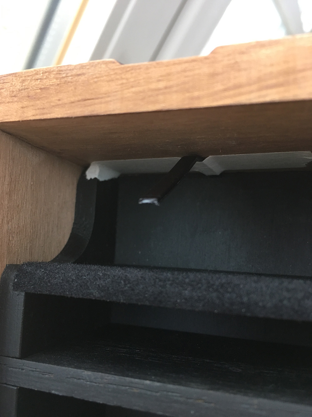

I've been having issues recently with my Ondu 6x12 Multiformat (second version). Every time I unload the roll it isn't tightly wound and getting light leaks at the top and bottom for the last few frames. For example, I recently shot a roll with the 6x9 frame size and three out of eight frames ended up with light leaks.
Does anybody have some tips on having the roll tightly wound?
I use it a lot for travelling, so I'd rather not have to bring a dark bag wherever I go.

Look at Holga modifications. I have a tab made from card stock and Duck tape that puts a little pressure on the take-up film. Holdas are a problem with fat rolls too and this works for me. I don't have a photo handy so show unfortunately.

Thank you Bernard and Bruce! I've checked what I have at home right now and taped a cable tie to the side of the take-up spool chamber and bent it towards it to put some pressure on the take up spool. It worked perfectly.
Here's a picture if somebody else runs into the same issue:
