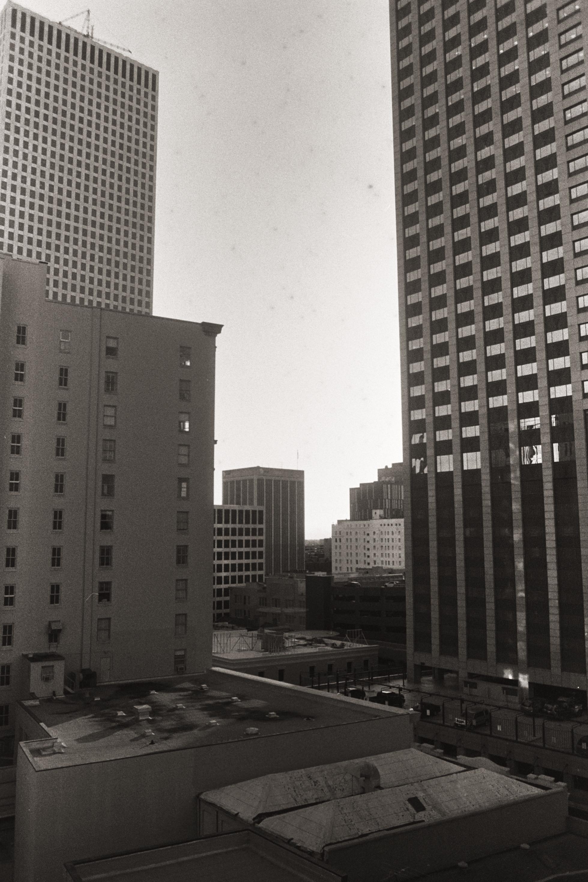

Tiny white spots on the negative. I'm troubleshooting with my developer (D-76) as I type but wondering/hoping if perhaps someone would be able to look at it and immediately diagnose it. I'm pretty sure it isn't dust, it doesn't look like dust to me and it doesn't look like other dust on my film strips, I think it's a chemical problem, just not sure what (my developer is within the 2 months I typically keep it for and my fixer tested good). Film is Arista.edu 400, here's my process and a sample photo:
Pre-wash (unfiltered water) / D-76 1+1 (mixed on October 2nd) / Rinse with water (no acid bath) / fixer (tested good with hypocheck) / rinse and photoflo
(white on the negative, dark on the positive below)

Thanks to a kindly PMer my number one suspect right now is air bubbles.
When you say "white spots" on the negative do you mean "clear" spots or spots with reduced density?
If so, that means either stuff on the film that prevents exposure, or stuff on the film/in the developer that inhibits development.
Or, rarely, something that is bleaching parts of the film.
I assume that you are diluting the D-76 to 1+1 immediately before developing.
Air bubbles or tiny drops of fix or stop on the film. The prewet is good, but use some heavy agitation.
Spots with reduced density, I believe. Stuff on the film/in the developer inhbiting development could be bubbles? I'm hoping it's that
And yes, D76 was mixed on 10/2 but mixed 1+1 immediately prior to dev.
PE
What do I do to mitigate the possibility of tiny drops of fix or stop on the film? Thorough rinse at the end?
No, better agitation at the prewet stage and more prewet. Make sure your hands are clean and dry.
Nothing after development can fix this.
