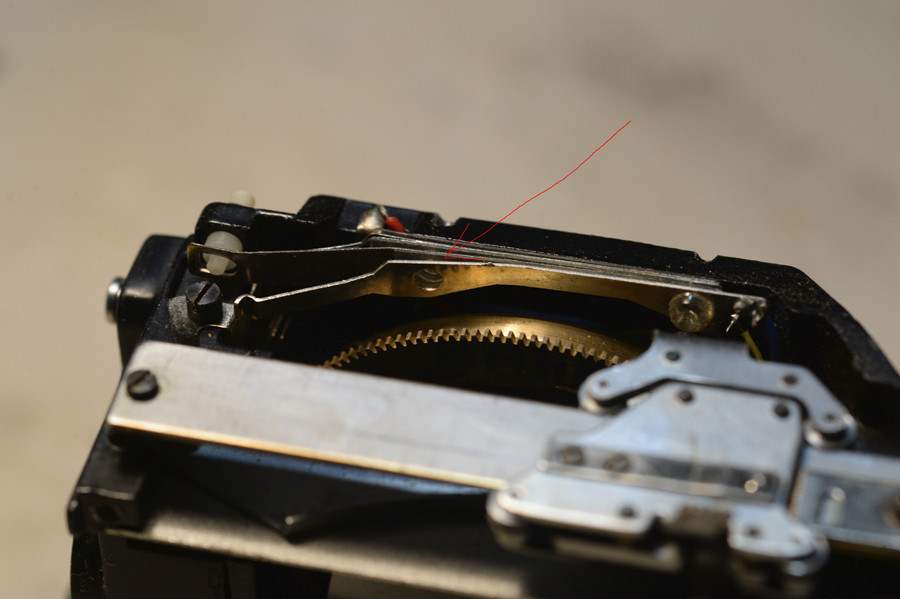

I need a small plastic screw to hold switch levers on a Ftn viewfinder. I tried a metal one and it grounds the current, so I need one like the one that remains near it. Here is a picture:
Anyone know where I can get one, short of buying a non-working finder?

It's actually a TN finder, not FTN (it has an N near the on-off button and the linger slot for the iris switch coupler).

The screw holds the switch leaves tight against the housing. The diameter is about 1 mm, and the McMaster source starts at 2 mm (I had looked at that weeks ago, but forgot about it as they did not have the right size). Thanks for pointing that out though.
I may be able to use a metal screw with a tiny insulating washer. It's not a big deal, it only matters for the battery check. The meter works fine otherwise. I think the plastic screw that remains is in good shape. It is not exposed to sunlight so that probably helps preserve it. The camera was made in 1967.

Does that screw function as a guide, keeping the leaves of the switch in correct alignment? If so, any number of improvised solutions might work very nicely, such as a small bamboo rod. Not too enthused about seeking an exact, vintage replacement, as we're talking about plastic that's more than a half-century old.
they seem to be of Nylon. So, half a century old won't cause any problem.This stuff lasts virtually forever.

If need be, M1 taps/dies can be had pretty cheaply, and I imagine that a 2 mm screw could be shaved down and rethreaded.

You can buy nylon screws in SAE 0-80 (about 1.5mm) or possibly 1-72 (about 1.8mm) from McMaster-Carr and probably other places. When you get to these small screw sizes, an SAE fine UNF size tends to be very close to a standard metric coarse size. For example, SAE 0-80 is close-to-not-quite M1.4x0.3mm (sort of in between that and M1.6x0.35mm), and SAE 1-72 is very close to M1.8x0.35mm. I don't have this stuff memorized, I made a table of screw sizes sometime ago that allows looking it up.
Because this is a tiny plastic screw, I would be ok with screwing an SAE screw that is a little off into the piece. The metal parts are likely to just reshape the screw threads a little. If no screw metric or SAE can be found, I would consider just shaping a little plastic rod to about the right size and turning it in, letting the metal grab the plastic. It might hold for another 40 years.

I used a small piece of black electrical tape as insulation and that worked. I just poked a small hole in the tape at the screw hole and used a metal screw instead of plastic.
