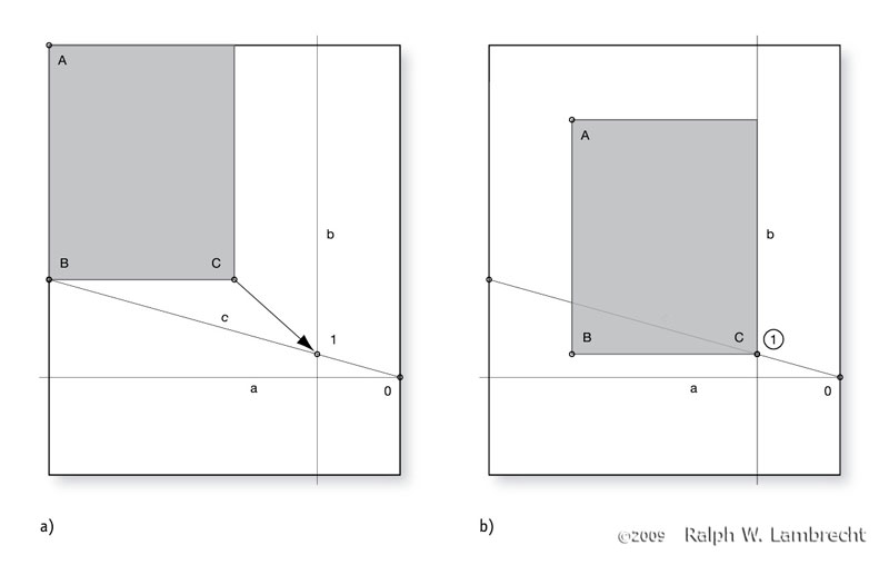

Yes, and yes. I mount to the optical center. I hope the attachment is self-explanatory. Lines a & b half the horizontal and vertical white space.
I do get it, but wonder where this originated. I have not seen this geometry before. It does look "right", though.

I have no idea about the origination, but I do have a 1938 book on print finishing, and it explains the technique without showing the geometry. The main point is to have the print just above the vertical center. If centered, the print optically 'sags' to the bottom. Most likely an optical illusion of some sort.
Dave
I have heard of a "stability rule", which is used in printing, composition, and even font design. Pretty much means bottom-heavy is normal. I used to be a draftsman, so your line construction looked interesting.
